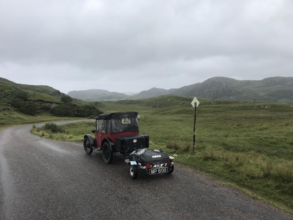

Tanya led from here, she had been looking forward to driving the famed “Road to the Isles” since she last did so in our Chummy 13 years ago. The weather did not let up and we only stopped briefly as the Ulster would soon start to fill up with water, if stationary. Every so often shards of sunlight would appear out at sea, but never near us, it seemed! The Road to Isles leads from Achiltibuie to Lochinver – the last 2/3 follows the rugged coastline tightly, allowing many coves and beaches to be viewed. Very little traffic uses the windy track and only a few cars passed us, they all waved cheerily from their warm cars!
