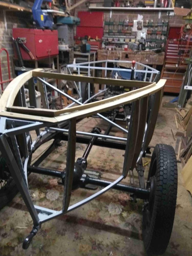

Ruairidh ,You could enjoy yourselves building something akin to Anastasia. I had great fun building the body on a steel frame , with teak shaping ribs to give some vertical curves. The sides / top are western red cedar, clinker built secured with polyurethane wood glue and brass nails.
.jpg   139 arriving at trim lizzies.jpg (Size: 133.14 KB / Downloads: 343)
