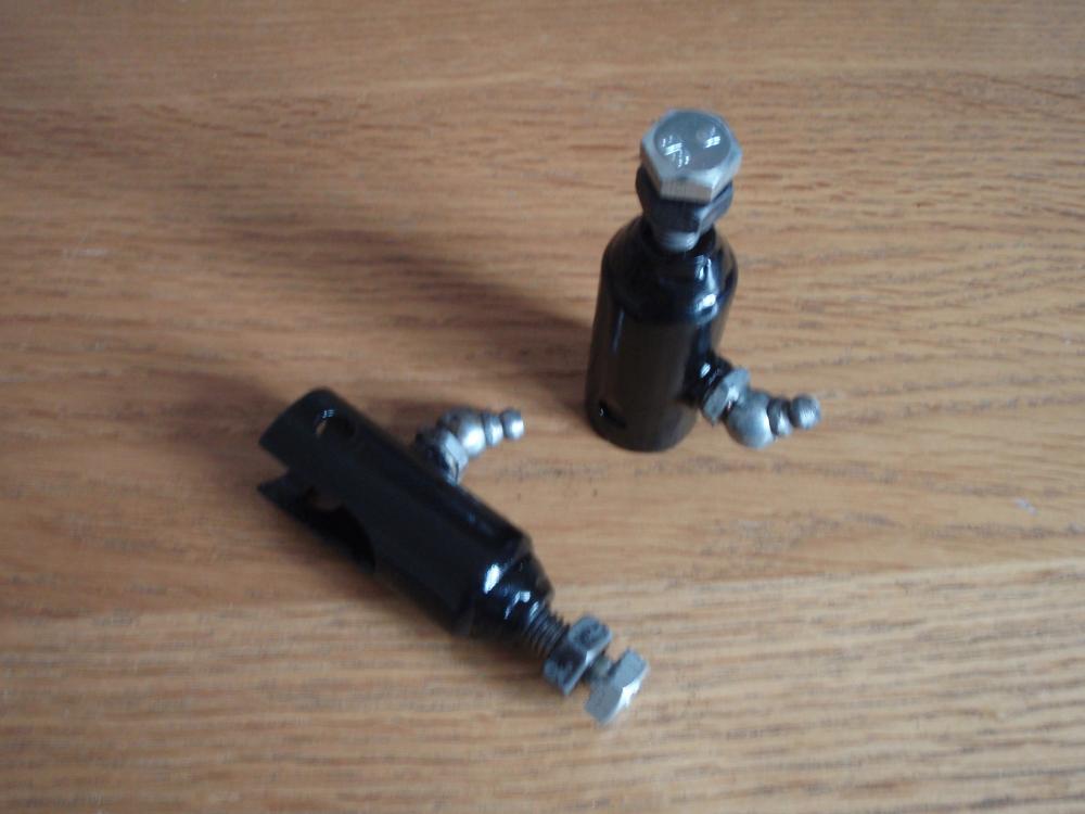

Hi All
I’m surprised no one has mentioned the mod detailed in the Dorset A7 web pages by Terrytuned.
http://www.da7c.co.uk/technical_torque_a...ations.htm
Probably not for the purist.
 I’ve carried this out on the special and it makes drag link installation very easy.  Simply assemble everything then tighten up the adjusting nut.  Rather than a locknut I use Loctite on the thread.
Pic below shows the two links and the additional mod of a grease nipple to make sure the back of the ball is lubricated.
#37
I made some up from the Dorset link and they have worked brilliantly.
