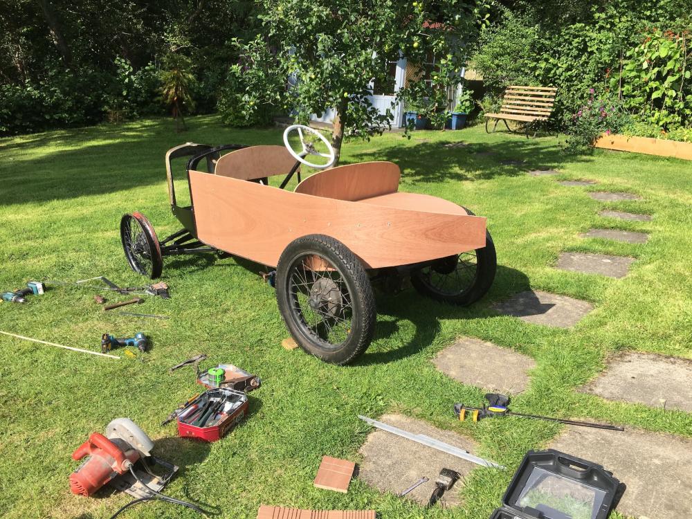

Hi All
A bit of an update.
The ply sides have been glued, removed from the car and sanded (to remove copies quantities of glue that oozed out when the sides were bent!).  The sides have been re-fixed and three layers of 3.6mm ply bent individually (using a heat gun and water) to form the scuttle top. This has been glued and forms a quite strong laminated hoop across the front of the car.  I've also spent some time "playing" with the double curvature rear section.  It too will have three layers of 3.6 ply laminated. So far I've got the first layer in place and already its quite strong.  It has been a bit fiddly cutting and bending the sections but I think the end result is OK.
Given the strength of the "shell" and being mindful of Ian's comments regarding ply thickness I don't think I'll need an external  skin of thin ply.  The fabric should easily span across the holes I will cut in the ply.  I will probably put a very thin (2mm) ply skin inside the cockpit of the car for cosmetic reasons.
The pic shows the car to date with the outline of the door.  I'm hoping to be able to remove the body shell without the subframe to fit the fabric covering. So once the door has been cut I will need some temporary support bars at the top of door height.
#39
Are you sure you're going to be happy with the angle of the steering column? It looks to be the standard Saloon/Tourer angle rather than the shallower sports angle. In a sports car, the standard rake leads to a 'sit up and beg' look and quite an uncomfortable driving position unless you fit the seats at a Saloon/Tourer height and that rather defeats the object of the exercise. Lower rake Ulster or GE steering boxes are available or you can change the angle via a steering box wedge. Perhaps something to think about before you go further?
#40
That is looking good Howard. Have you though of having just the one door on the N/S and half depth? It would reduce the weakening of the the side and with a folding step below would be a very 1920s sports cyclecar look...especially with a lower rake on the steering column.
