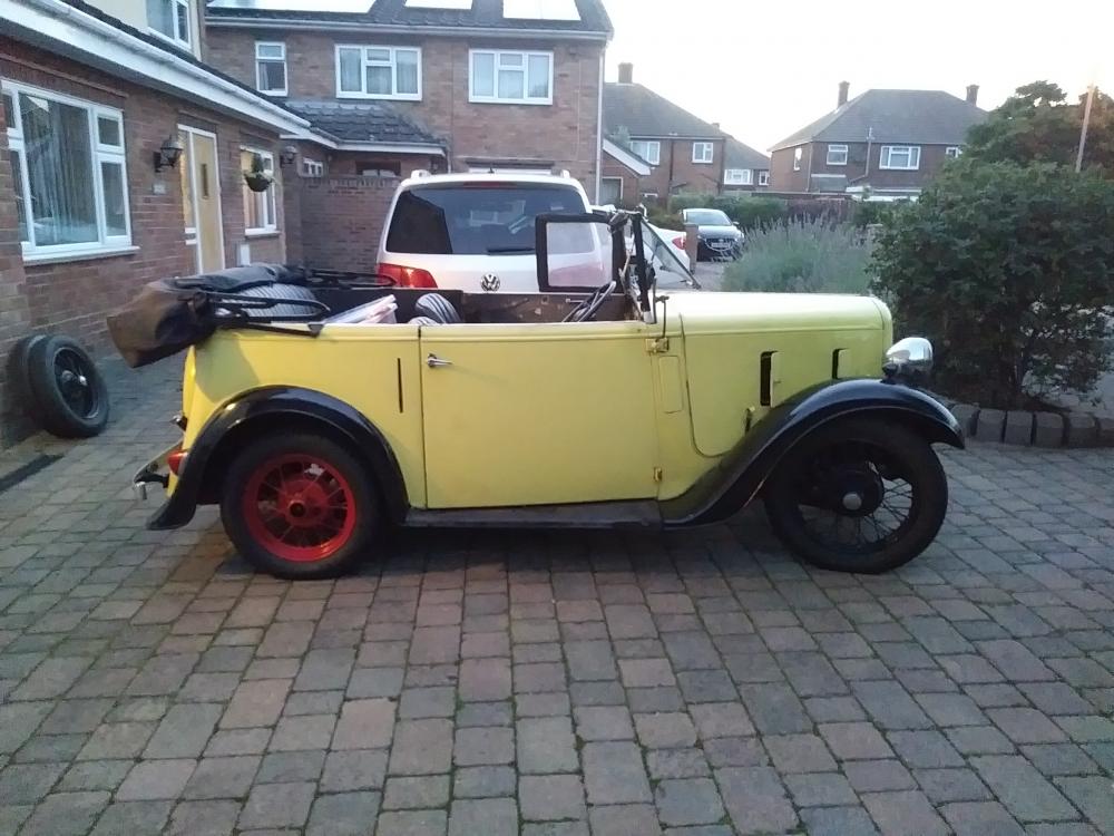

That's sage advice Greig.  I'll look forward to Mrs L's bemusement as to why I smell of rubber and baby powder!
I'm blaming the weather. I've done several without problem before... including fitting the 5 tyres on the ORT now. I'll just have to borrow a space-saver spare from the Speedex again until it gets a bit warmer!
Ok... So this was last time and just to keep it moveable.
