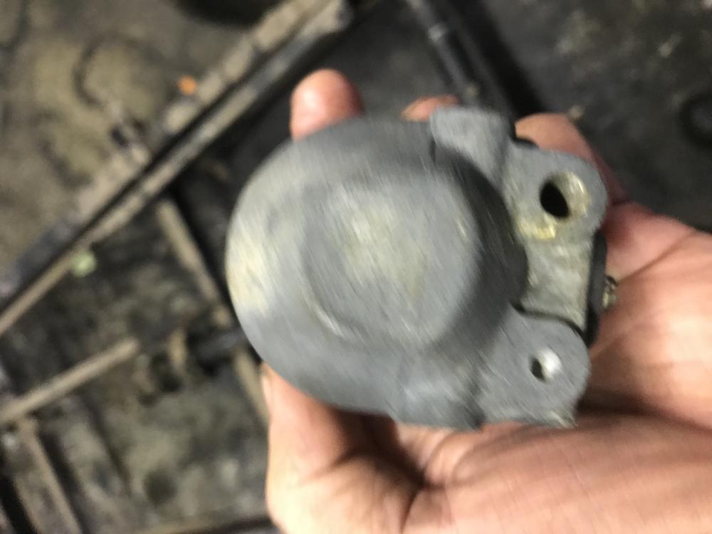

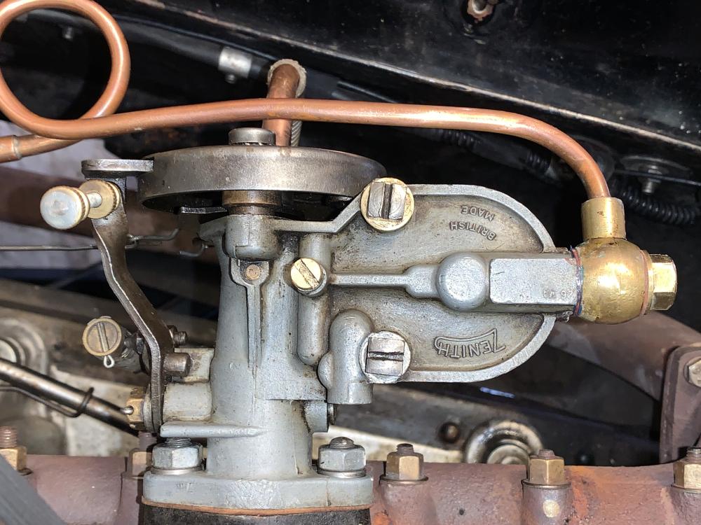

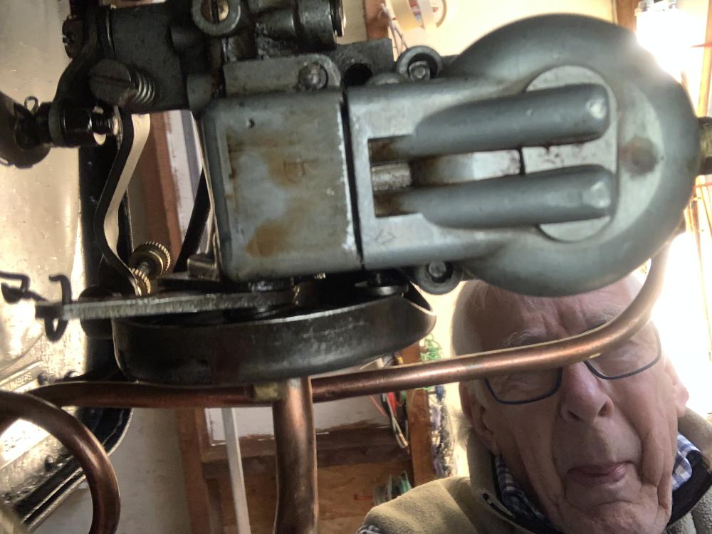

Here are the pictures asked for by Ruairidh. Additionally I have 2 spare bowls which I now see are different. Is the correct one fitted? Item 22 seems to be fitted correctly. I’m now leaning toward ineffective choke.

You have the incorrect (later bowl fitted).
I will find a photo of the correct bowl that you need and post it up.
#26
Also:
- in the top photo, your choke is not fully closed.
- you appear to have a later crankcase in the car, this will allow you to fit a mechanical fuel pump, which I recommend you do.

You require a bowl like this…
#28
Ruairidh is spot on, the choke is not opening fully due to the strangler lever fouling the cowl distance piece. Said lever is moving laterally. Strip and find out how to contain it in the correct plane to fit into the groove rather than against the body. I do like it when a reason for a problem is properly identified.
#29
Hi Ruairidh - Please could you explain the different bowls - two stripes, one long/one short and no stripes across the bottom? When are they right and/or wrong?!
#30
Peter: do also take note of Ruairidh's note regarding bowl type. I did and it massively improved running to have the right bowl with the right top.
Andy
This was an earlier thread with more info from R regarding bowl types, basically 2 lugs on top goes with 2 lugs on the bowl, one lug goes with a domed bowl:
https://www.austinsevenfriends.co.uk/for...4#pid27324
Although mechanically interchangeable and not obvious unless the carb is off the difference in performance for me was significant.
