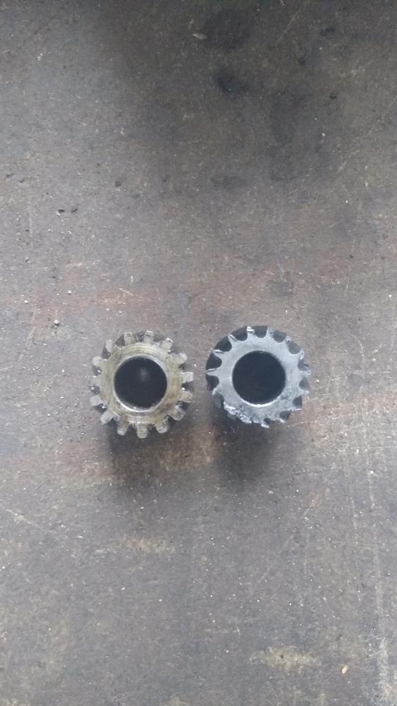

Spot the duff one...
#23
I remember years ago Andy Hastings checked over an engine for me and the time came to put it on his test bed.   When I arrived at his garage he looked puzzled and said he couldn't understand why the engine wouldn't run.   He had put a distributor on the engine that was in good condition.   It transpired that the drive gear on the distributor was at fault, not because it was made out of chocolate, rather it had one tooth more than standard!
#24
Similar looking gears exist for the coil conversions on Austin 12 Taxis. They have a different number of teeth, don’t ask how I know this…
