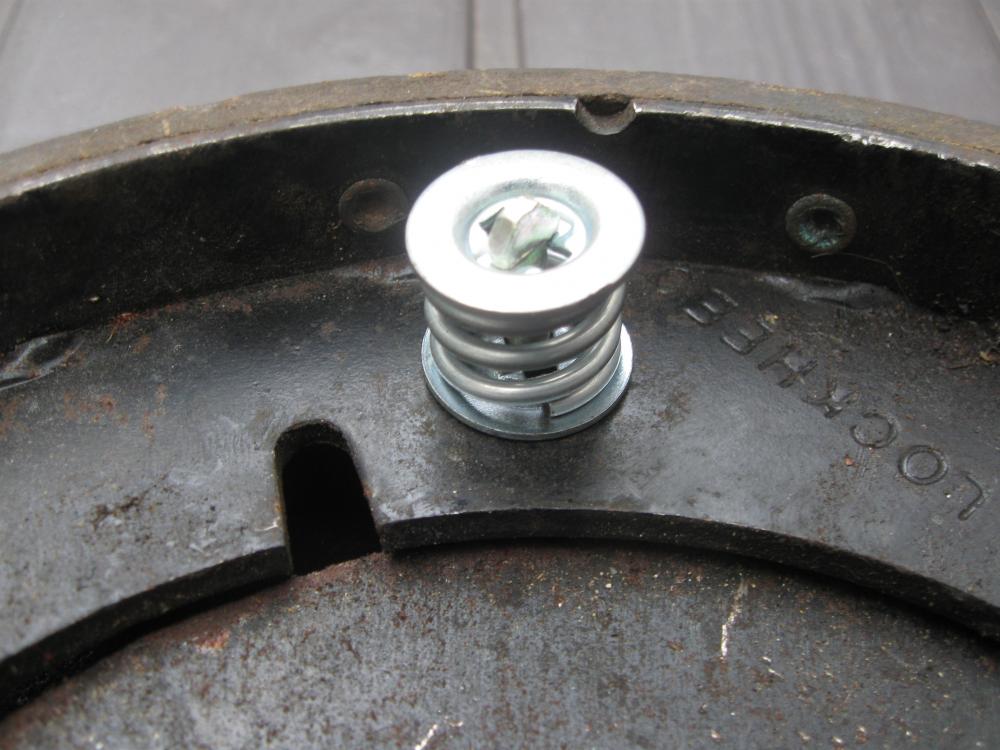

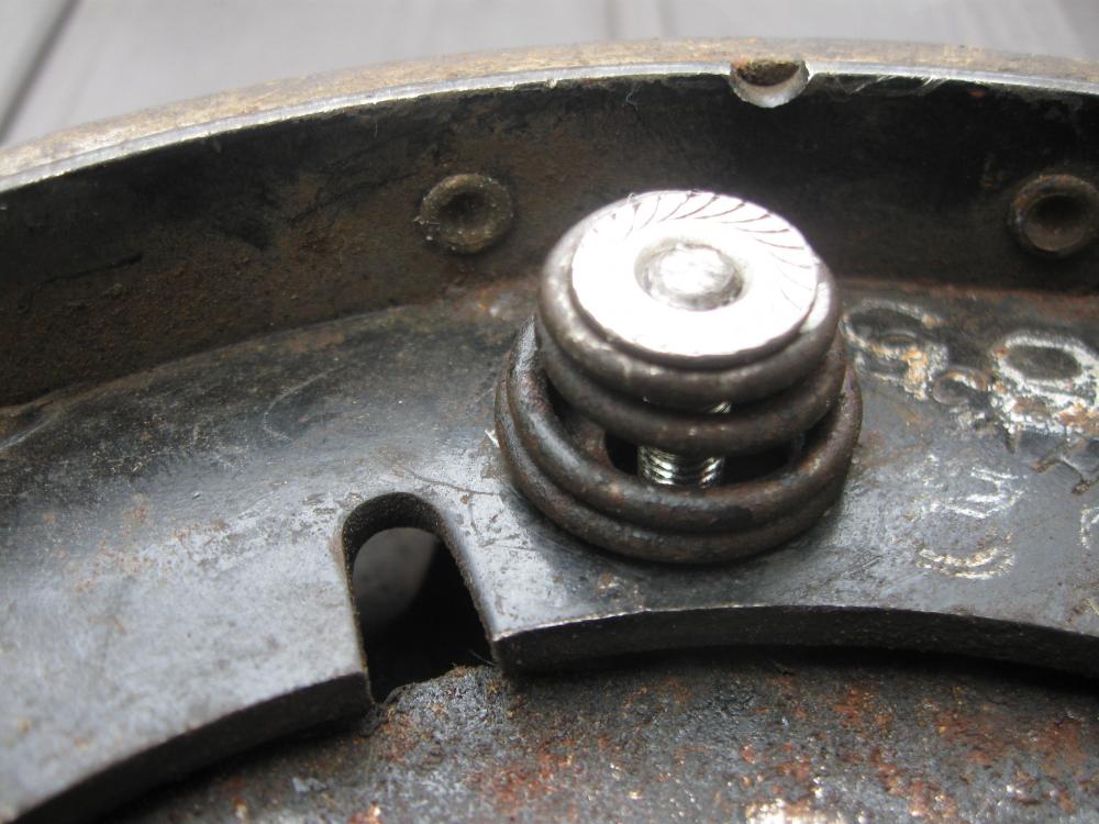

Brake shoe back plate retaining springs, I use Girling shoe retaining springs much better than the lockheed bee hive springs (see photos) If you want to use your existing bee hive springs cut out the centre leg retain with a 5mm screw and upside down 5mm flange nut.

Just wonder if the springs are needed at all or just bolts set to correct length.
How did you decide where to drill the hole in the back plate?   presumably you have this system fitted and working and the shoes will travel from fully in when new to their fully out when worn position without fowling the bolt.
