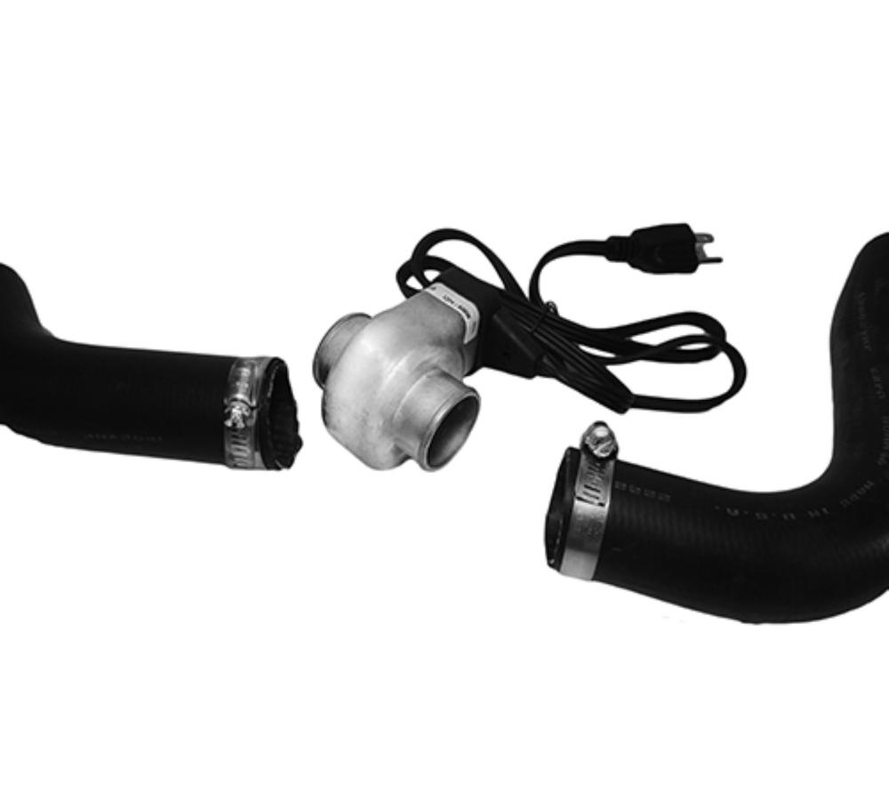

I've been on the look out for a bray engine heater for some time with no success
.jpg   bray.jpg (Size: 74.66 KB / Downloads: 129) eventually I found a modern equivalent      which is fitted in the lower radiator hose. Unfortunately it is American and is 120 volts but at 600 watts it gets the engine nice and toasty in an hour. This is something I've wanted to do for ages because all the engines we built at work were pre heated prior to starting.

(11-04-2023, 05:10 PM)Dave Mann Wrote: I've been on the look out for a bray engine heater for some time with no success eventually I found a modern equivalent  which is fitted in the lower radiator hose. Unfortunately it is American and is 120 volts but at 600 watts it gets the engine nice and toasty in an hour. This is something I've wanted to do for ages because all the engines we built at work were pre heated prior to starting.
120 volts. Mmmmmm, buy 2 and wire them in series, heat up the car twice as fast!
