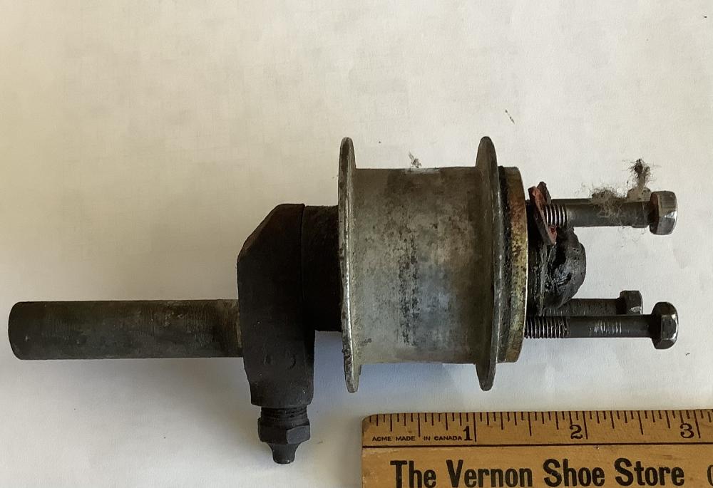

Hi Steve: I have this one you can have for the postage. I’m in Vernon.

(11-02-2022, 08:46 PM)gord Wrote: Hi Steve: I have this one you can have for the postage. I’m in Vernon.
Gord that would be great. Let me know the best way to reimburse you for postage.
