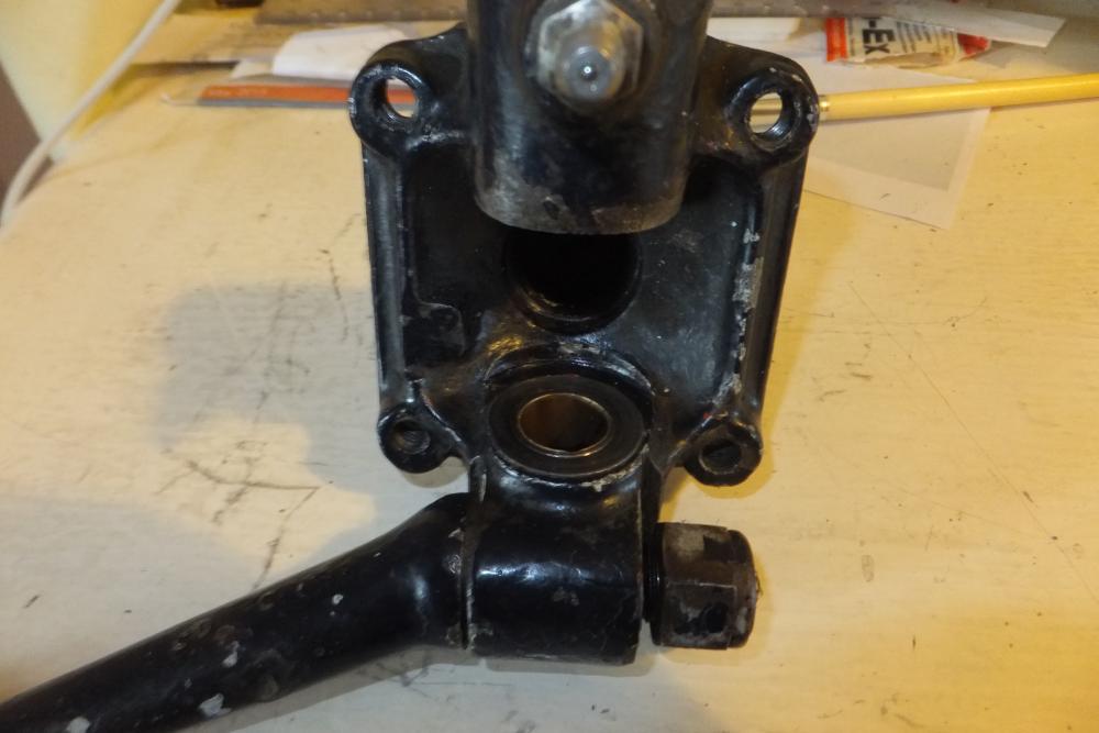

Hi Chaps
Well I have got the front axle off the car and there is wear in all the bushings so I'm making a list and ( checking it twice). Here is a pic of the leaf spring. The leafs look like they are not inline and run off on the other side forward, could that be caused by the worn bushes? Pick of the apparently one year only stub axle. and some rubbing on the axle. mmmm Rolleyes Huh
Dennis I like the tool, I think I will be needing something of the same.
#24
Colin, unless I have missed it, no one has mentioned the fit of the kingpin in the hole in the axle beam and if the beam itself at this zone is sound. This hole sometimes has been worn owing to the cotter which locates the kingpin in the axle coming loose. Also people have bored out the hole in the beam and fitted a thin bush to bring the hole to standard size. This is a bad idea as it leaves only a small amount of material on the outer edge of the beam and quite quickly the axle will crack between the bush hole and the outer edge of the beam. Obviously this could be very dangerous. If the beam hole is worn, it can be brought back to standard and the outer edge of the beam strengthened with weld. One of A7 Friends "cherished suppliers" is very good at this. Another point is you cannot remove the cotter until you have taken out the kingpin as the cotter has a half moon shape rather than the more conventional taper.

#26
Colin
The axle eyes need to be good or your time will be wasted.
Take advantage of the service that Mr Dunford offers - that part of the operation is not really a DIY job.

#28
If the kingpins are worn reaming is somewhat difficult with the early models as the bore is normally obstructed for a stock reamer. I dunno if removing the brake bush gives enough clearance but it is not a big deal to remove the backplate.
#29
It is also good to check that there is no twist in the axle beam.  A half inch rod in each king pin hole should be seen to line up with each other vertically and be same measurement from eye top to top of opposite rod (obviously with tops of rods at same heights)  The longer the rods the easier it is too see any difference if any.
