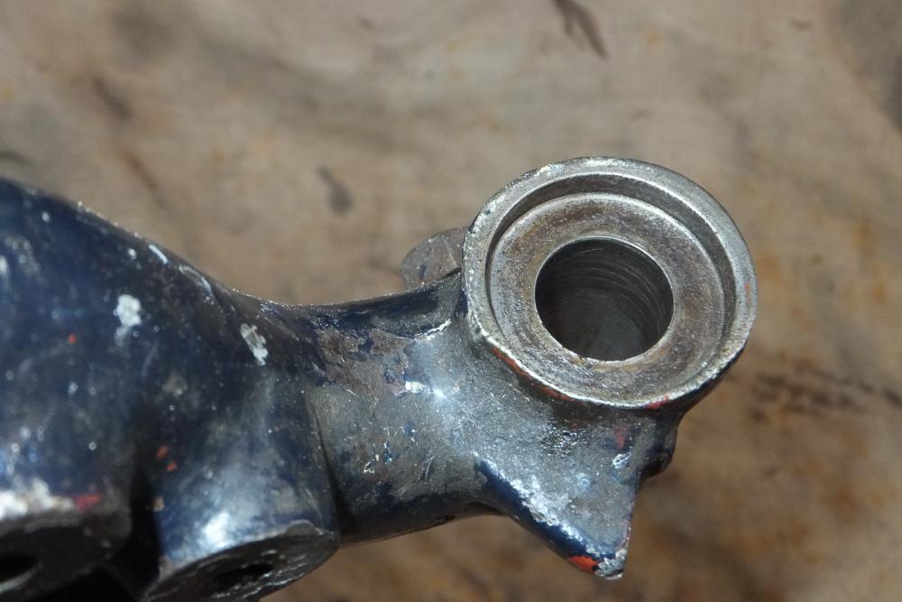

Only faces accessible for filing are the top of the axle king pin eyes.......would you be confident enough to guarantee a FLAT surface AT 90 DEGS to the king pin?
Underneath of eyes are in a recess.

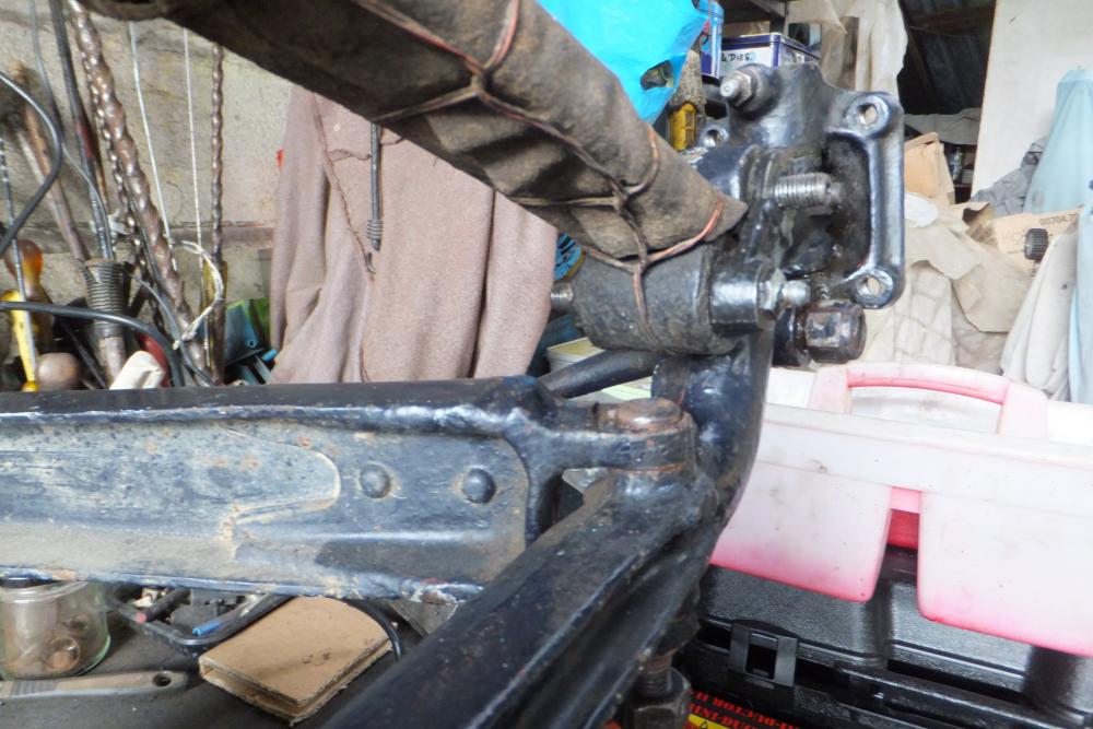

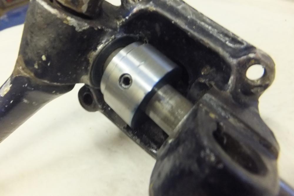

Have a look at stub axles and you will see that neither face that goes next to the axle eyes is accessible for filing......hence pilot and cutter or cylinder for grinding.
recessed axle eye under axle.
Pilot and cylinder in position for grinding stub axle eye faces

Nicely ground flat (shown by bluing all over) and at 90 deg to king pin
