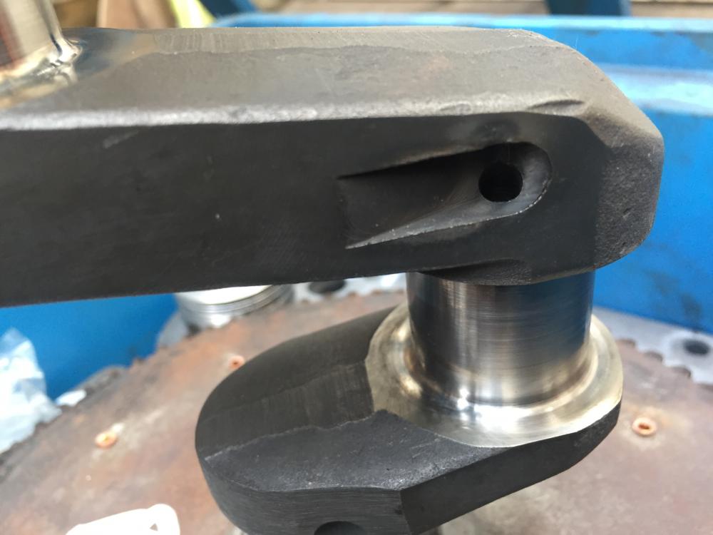

The oil troughs on the Phoenix crank are still as supplied.

The Phoenix crank fillets seem nicely finished with reasonably uniform radii. Being very hard, is there any measurable crank wear?
