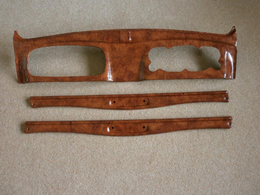

Both my & my Uncle's Mk I's have the dashboard covers (1934 & 1936 respectively).
Underneath the patent plate on my car was a painted wood-grain finish, sort of darkish oak, unfortunately, I do not have a photo (that I can find), was not an inspring finish.
A link to the Cornwall website, my find was similar to this:
http://www.austin7.org/Technical%20Articles/Woodgrain/
When the time came to do mine, I did not feel competent to do a wood-grain paint-effect finish so I opted to do a vinyl-wrap finish mine using a wood-effective 3M as an economical and effective representation of an original type paint-effective, clearly not the same as the factory finish (and not like my original, which I thought was dreary), but fools most people looking at the car - the factory was fake & so is this!
I bought the 3M to do both cars, patience is needed to get a good fit, the 3M needs to be heated to follow the curves & contours - Uncle's now has a painted colour dash & door cappings...
Mine with the vinyl-wrap before fitting to my car 2014 - lots of different wood-effects are available
Dash of a supposedly "original" car (was for sale in NI about 10 years ago)
From an early Mk I, fairly unmolested car taken about 10 years ago, what the paint finish was is hard to tell...

Looking at that photo of the Northern Ireland car, I reckon that finish was screen-printed onto the flat sheet before the panel was pressed, so it's unlikely you will be able to reproduce it exactly. It looks like Gary has used a walnut wrap - I suggest you want to be looking at a dark oak or maybe rosewood finish to get your dark brown look.
#28
In which case mine is Walnut not Mahogony as I used the 3M reference number Gary posted several years ago on the old forum
