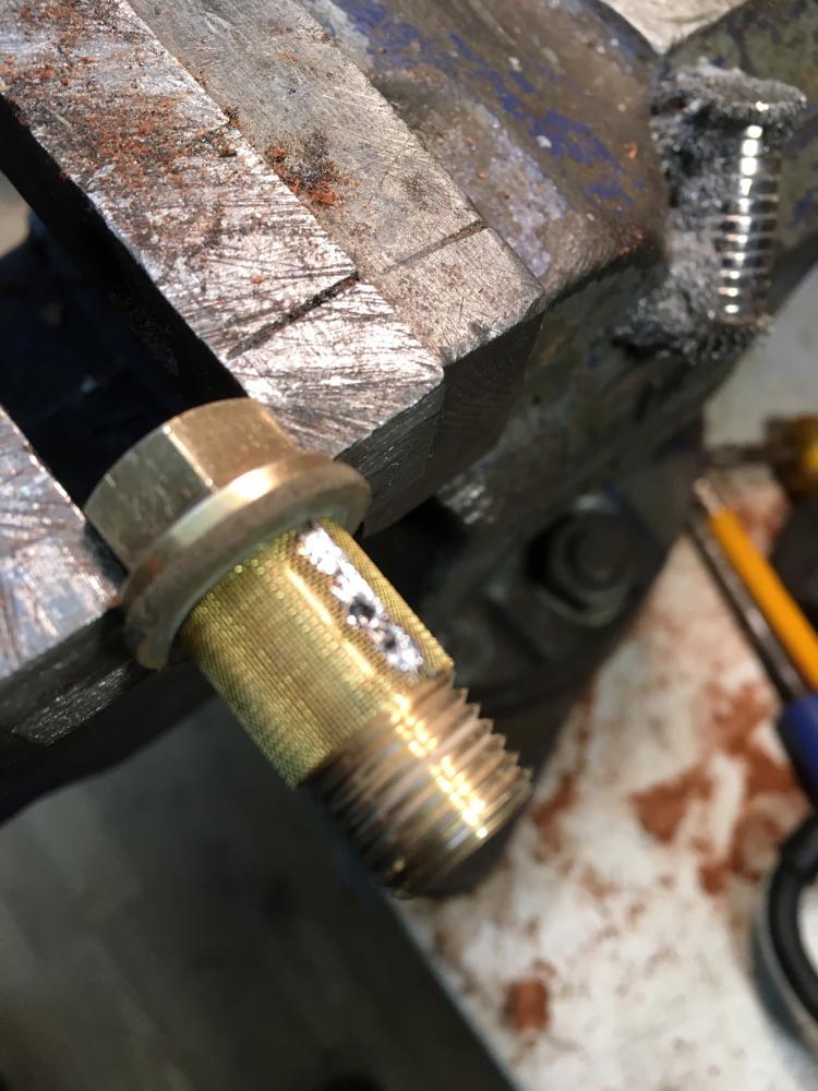

For the first time in four months I had a good run out today staying within the COVID limited 5 mile radius from home but achieving 20 miles in total.
However the trip was cut short when a strong smell of petrol led me to the carburettor which was pumping petrol out of the top of the float bowl. (1 1/8” SU Carb) A sticking needle was soon sorted.
This is what I found when I dismantled the inline filter, float bowl and fuel pump at home.
I did not have a filter in the carburettor banjo so proceeded to make one from fine brass mesh.
This was cut to size, rolled round a bar then fitted in place, a touch of solder along the join to finish.
Hopefully this will cure today’s problem. As long as I remember to clean it occasionally!
Roger
Location:- Haverfordwest, Pembrokeshire.
Certainly looks better than a hideous plastic in line filter.
