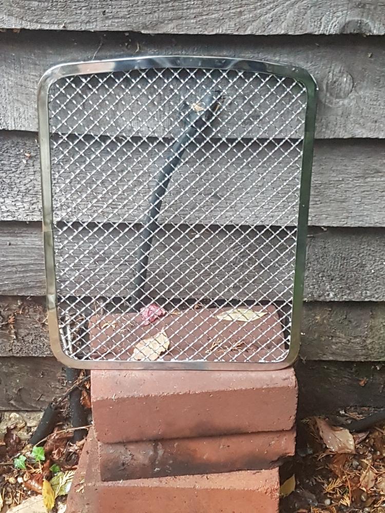

Finished the radiator stone guard.
Brass angle, machined to make it unequal, bent, silver soldered and plated at home in bright nickel to match the rad.
