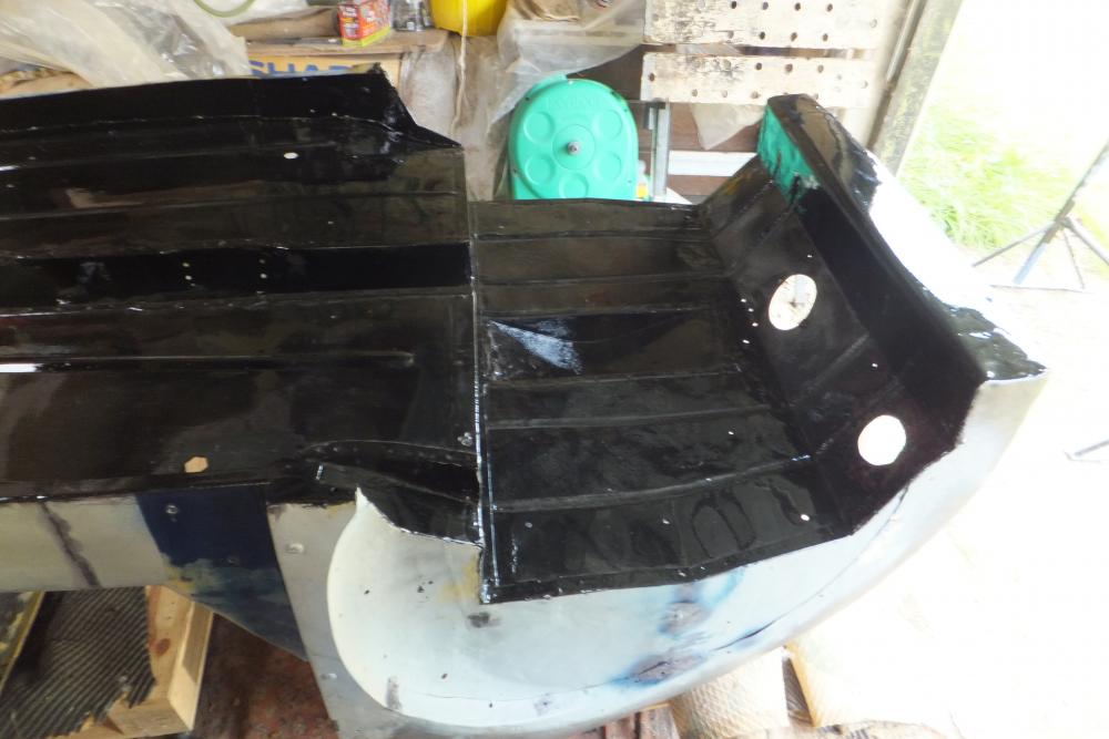

Painted my babies bottom!
Underneath of footplate with tube for steering column to have grommet against draft.   No pedal slots so warm tootsies.
