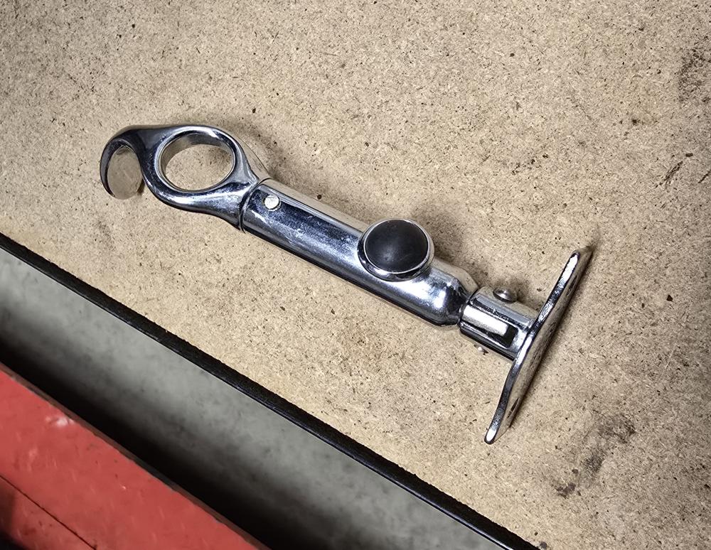

I also have two of these, which I think may be bonnet-securing "latches", but they do not match the mounting holes in my wings and seem a bit "grand" for my RN. Any ideas?
There are only two mounting holes in the base of these and my wings are expecting three. The spacing of these mounting holes are also further apart than the two at the base of the "triangle" of holes on my wings, so to fit them would require some drilling. If they're correct I'd be happy to do that but if not I'd rather source the right bits.

Far too fancy for a Seven.  This image grabbed from the Oxfordshire Sevens site is what you want. All the cherished suppliers normally stock them.

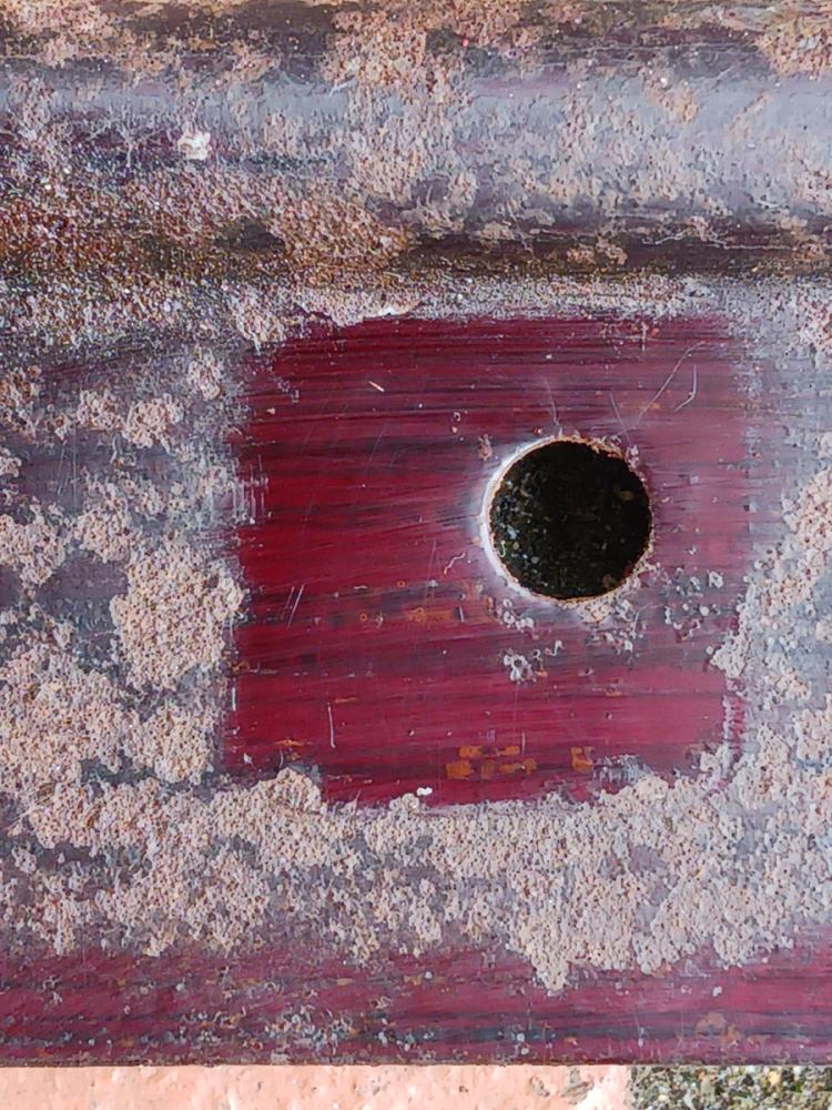

Here's an original sample from an RP door cap -
It is by no means a "faithful" reproduction but keep in mind this is somewhat magnified, you also can't see from the photos that it's buried under a smooth gloss varnish, so it does give an impression of being polished mahogany or something of the sort.
Colour reproduction on computer screens is a fickle thing, but I took a sample to my local paint shop and they produced a Fiat red which is a very near match for the base colour (it's not unlike red oxide). I have yet to match the other hues, or to figure out how to apply them for the same effect - bristle brushes are probably the answer, but for now I have more urgent projects demanding my attention.
