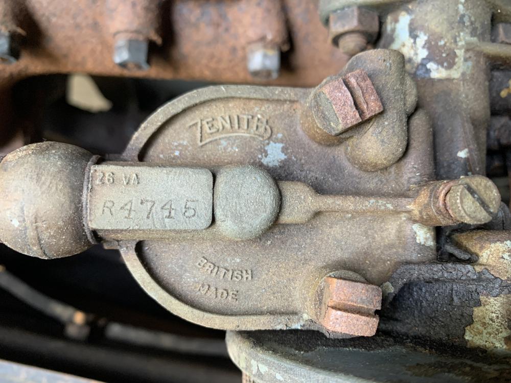

The two holding down studs for the carburettor top have a squared lower end which you can use to remove the two jets in the bottom of the float chamber. They need to be blown clear.

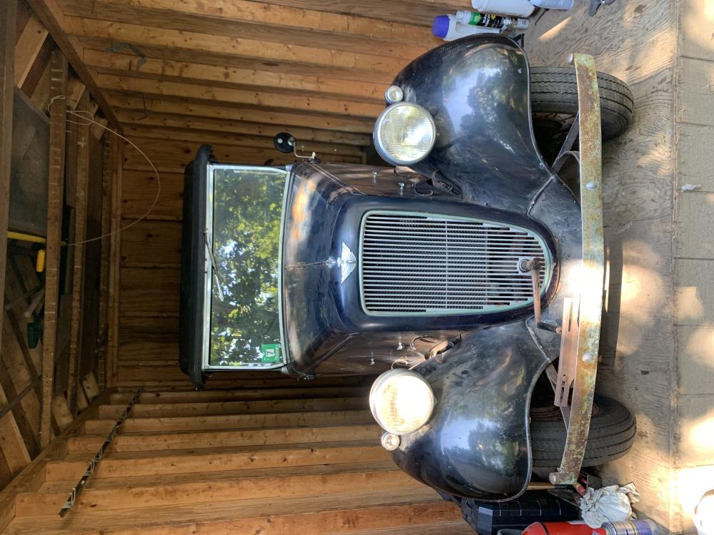

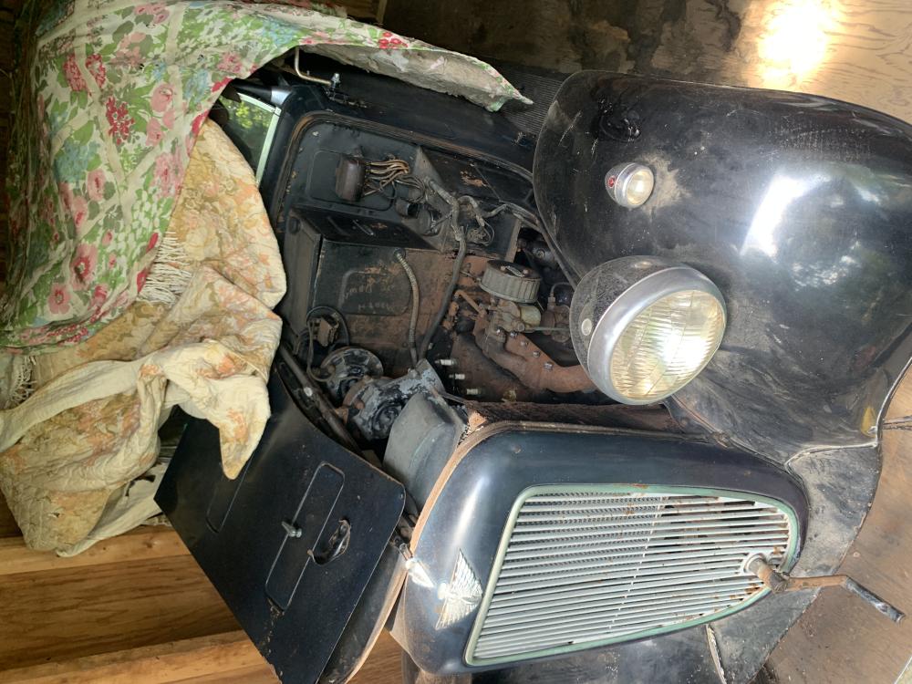

Hi Jason
Looking at your pictures this seems quite an interesting car. Left hand drive with a bench seat but with a UK engine layout. Could you confirm that all the photos are as taken and not mirror images?
Perhaps the historians amongst us could enlighten us on whether this was common?
Good luck with getting it going.
