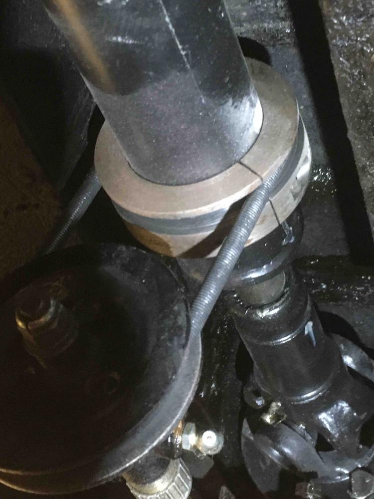

Yes I have. Basically made a split pulley same outer diameter as the original inner made to fit the new propshaft.
It works a treat.
I can send you a picture if needed.

Hi Nick, yes please a photo would be a big help.

Thanks. That seems it wii do the trick.
