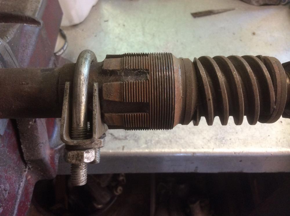

When I did my steering box I took off the front plate complete with gear wheel and steering arm. I then gripped the column in my vice and screwed the box from the column. It was tight so I completely removed the pinch bolt and gently tapped a wedge down the opening to open the threads a little. It does not want much at all the free it up. It can off then and all went back together ok with the pinch bolt tightening thing up again after adjustment.

With mine I put a narrow brass drift into the slots for the now removed locking bolt and gently tapped it round to unscrew it as I hadn’t got a ‘C’ spanner.
