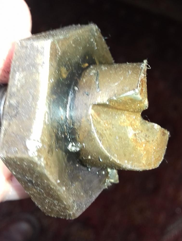

The pictures show some parts.
Early Handle. Note the handle has no sleeve and 7/8" shaft.
Early Starter dog.
Later 'pin type' Starter dog.

Here is mine on theĀ engine I'm trying to build up (or rather unite with disparate parts lying around). So I can now see the shaft is wrong for the dog and bush... but what about that thread combination from the earlier pics? The nosepiece must be original so is the bush an aberation... or do those threads look like they will work when the female end is cleaned up?
Is your bush for 7/8" shaft? The thread looks a bit coarse to me but difficult to tell from a picture.

Personally - I would change the starter dog for the later claw type (primarily because they work and are very easy to obtain), this will work with starting handle shaft you have. Then find the corresponding nose cone and a suitable starting handle (you were going to post a photo of what you currently have - if you do this we can tell you which shaft it is for).
The other photos are in post 10. I only have the 264 nosecone with the (possibly separate) bush, and don't have a handle yet. So if anything, it seems that the shaft is the odd one out?
