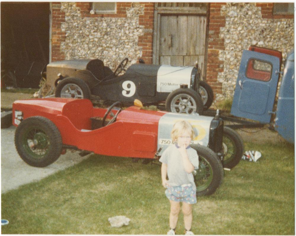

It's the body from this car. I built it in 1979, cheap plywood, doped Irish linen and an absolute minimum of metal.
It was on a 1937 Ruby chassis with extensions supporting my Box saloon fuel tank. Wide Bowden front axle. Bowdenex brakes. 15" wheels. 1934 engine, 4 speed Super Accessories gears.
Painted bright red with Woolworth's enamel. It was raced very successfully by Kevin Martin. It was known as The Red Car.
In 1982 I modified the body to get a much lower seating position but before I could finish the work the driver had moved on to other things!
It was never re-assembled but most of the components are being actively recycled.
Henry-  great to hear from you, and to know where the car came from- yes indeed cheap ply, but no remaining doped linen!
I'm assuming that its on the same chassis, but modified- or did you have a dropped front axle? It's difficult to see on that photo.
It's got a finned Cambridge head, and SU manifold at the moment.

Thanks for that Simon- I am wanting to get it going fairly quickly, so take note of that advice.
I'm not intending to fit lights, and I guess it will be dead easy to bump start.
It wouldn't be too difficult to shorten a standard dynamo if you have a big enough lathe and a scrap dynamo - Obviously, it wouldn't be a dynamo once shortened ! Sorry, I can't remember where the photo came from.
If the engine is tractable, you might be able to start by lifting a rear wheel off the ground onto a suitable stand and turning it in gear.
Sounds daft, but maybe easier than pushing - or maybe you have a handy hill to park on.
I have seen a lowered car with the starting handle working through a hole in the radiator core.
With a tuned engine I think you are going to need a starter.   A 12 volt system would help a lot, in a no dynamo car.
Again, with a tuned engine, a fan may be important.   But, if it was mine, I'd drive it first and find out what I could get away with, rather than have it in the garage in bits.
