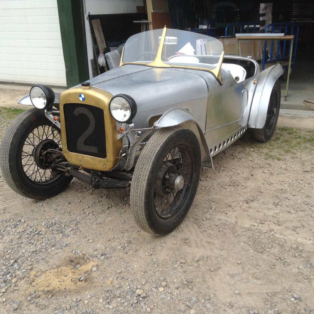

Well, that's the first modification in place, the "vertical coil" in the pipe is now a slow downward spiral, and the horizontal bit slopes about 15 degrees upwards. The problem is that it takes about an hour or more of uphill struggle on a hot day to repeat the conditions. Mind you, France is going through a heat wave at the moment.

Your intial photo seems to rekindle the old question about whch way around the bonnet supprt bar should go. it has never occurred to me to not have the closed retaining loop to front. If experimenting with bonnet unlatched it could matter.

Bob C - never thought about that one, but it should be on the to do list pretty soon - well spotted. It would be a shame to have an over heated engine bay AND loose the bonnet at the same time !!
