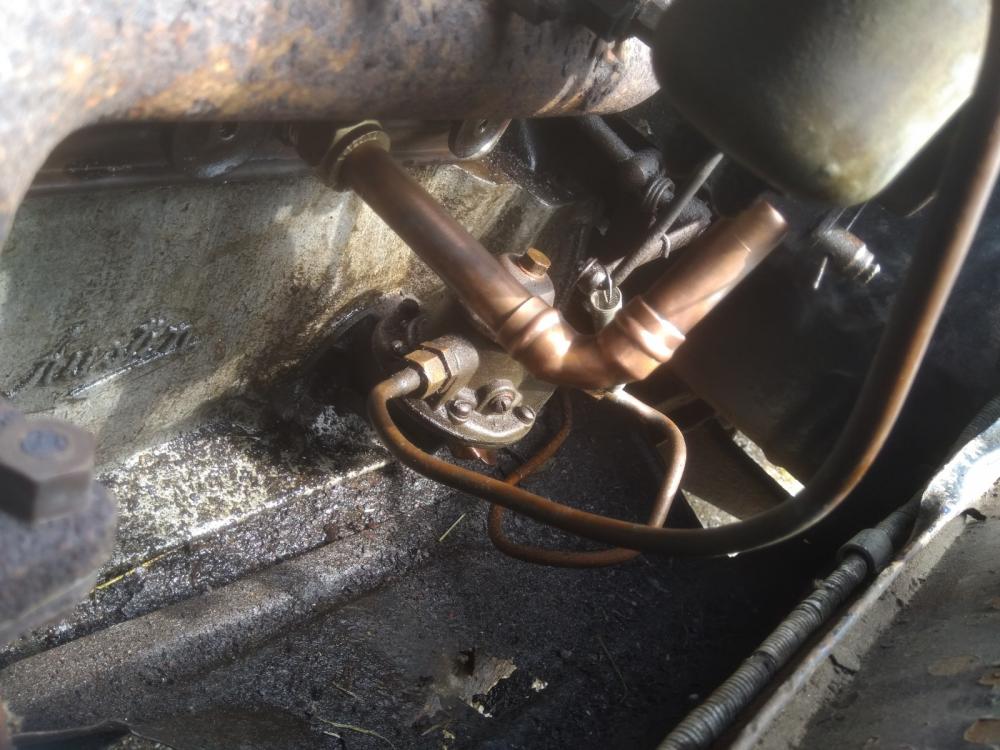

I've hopefully attached a couple of pictures of what I ended up doing in the end. I found an old valve chest cover I lying around which had already been partly butchered for an outlet, and combined it with a bit of old plumbing to direct the fumes into the carb.
I've been very surprised at how much of a difference it has made, I wouldn't say it's 100% cured, but a good enough difference to have been worthwhile and to make driving the car substantially more pleasant.

if you turn it through 90 degrees. and fit a 6 foot long piece of heater hose zip tied to the chassis venting out the back somewhere, it will be 100% cured!.
I'm not sure how much oil is swimming about int the valve chest, but if it's significant you're at risk of pulling over loads of oil through that new outlet due to it being low down in the valve chest area - would potentially be better if at the top with some sort of oil separator/gauze or at least a direct splash shield behind it.....

I think Ray has a point though, I'd keep an eye on how much oil it's shedding.
You wouldn’t have to strip it. You can change the valve guides in an afternoon, with the engine in the car. In this case probably as quick as an effective bodge.
