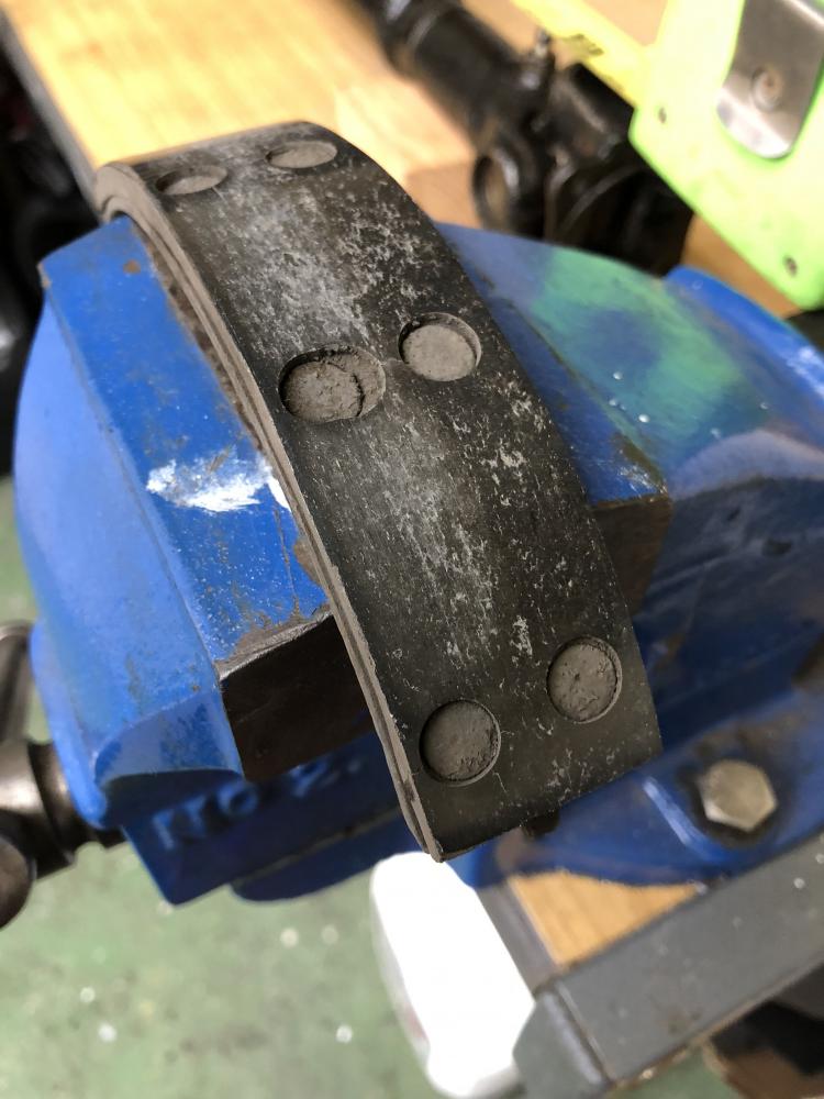

Just got the shoes off the car. The current brake lining material is a very dark brown colour and appears to be absolutely rock hard. The shoes are very shiny and there is very little dust.
I’ll report again once the new, softer material is used.

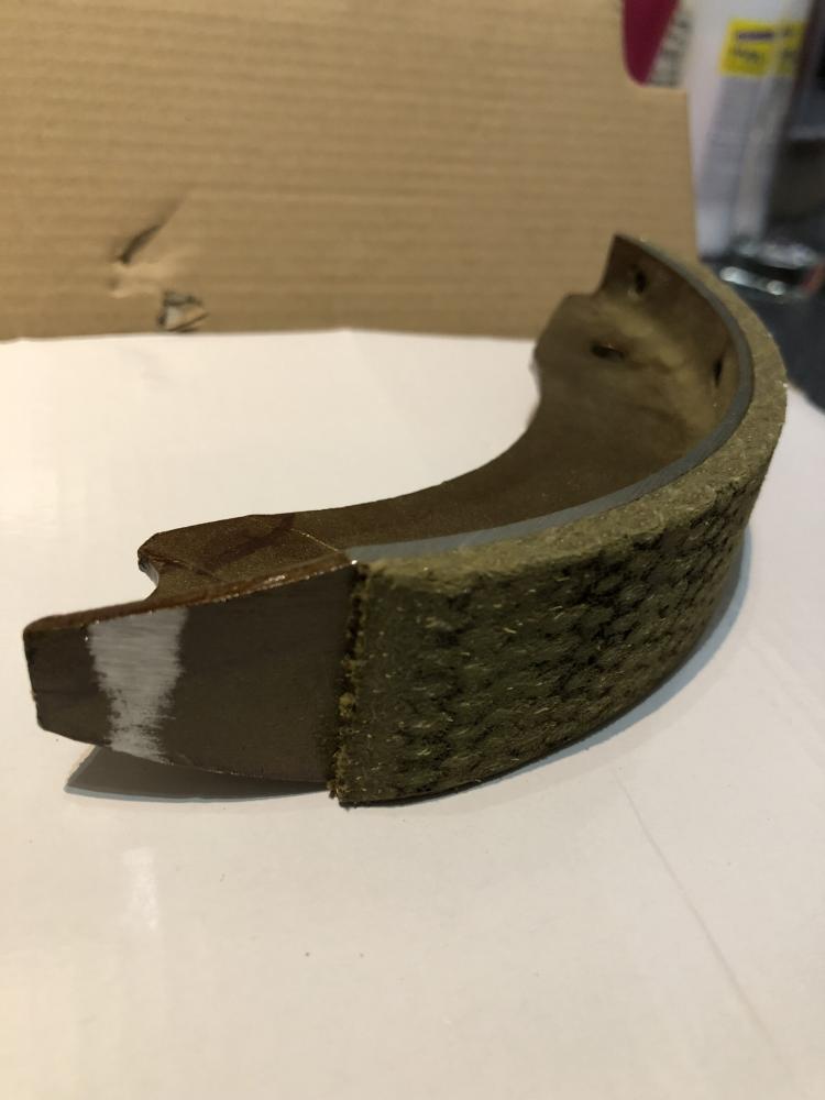

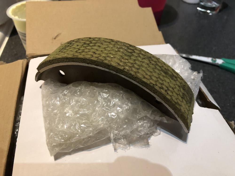

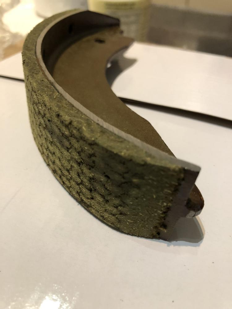

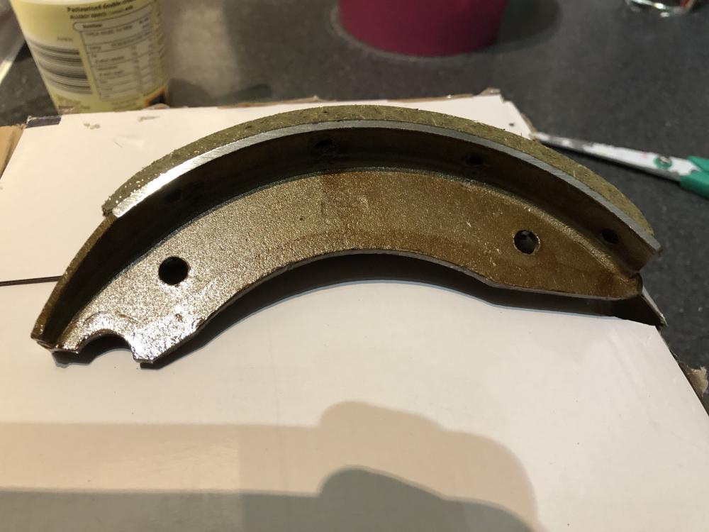

I got the shoes back from Saftek today with the Green Gripper linings. Looks much better than the very hard black material that was on there before. I’ve also had each end of the lining chamfered as recommended by this forum.
My only disappoint is that they have bonded the linings rather than riveting them to the shoe.
I will report back once the brakes are back together and I’ve done a test drive.
They may be bonded but just think of all that extra brake shoe area you get not having the rivets !!! (every little helps).
