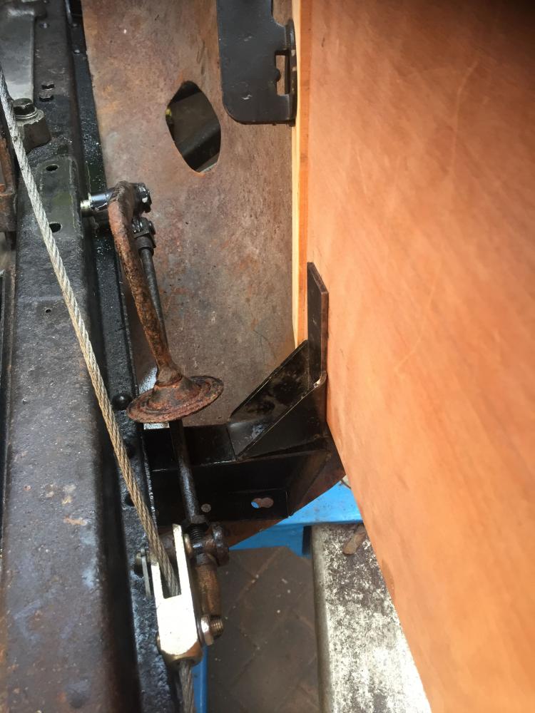

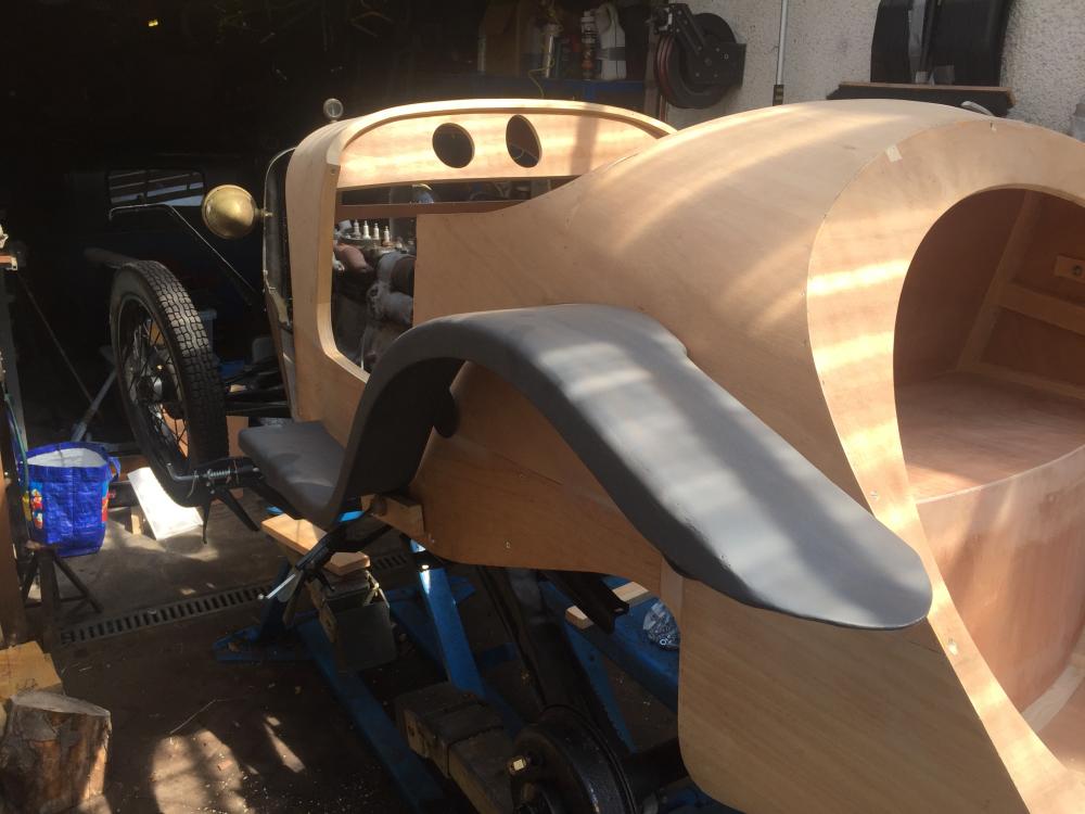

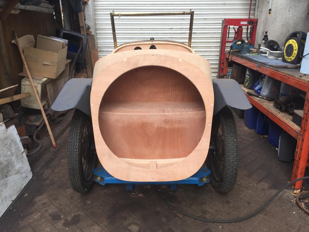

A good day today, the body, doors, windscreen and rear wings are all fitted correctly.
Positioning the body brackets...
Lining up the front with the flitchplates...
Checking for rear axle clearance...
Fixing mounting brackets with coach bolts...
Attaching rear wings...
Doors and screen fitted...

Lovely rear wings there.....
Aren’t they just!!
