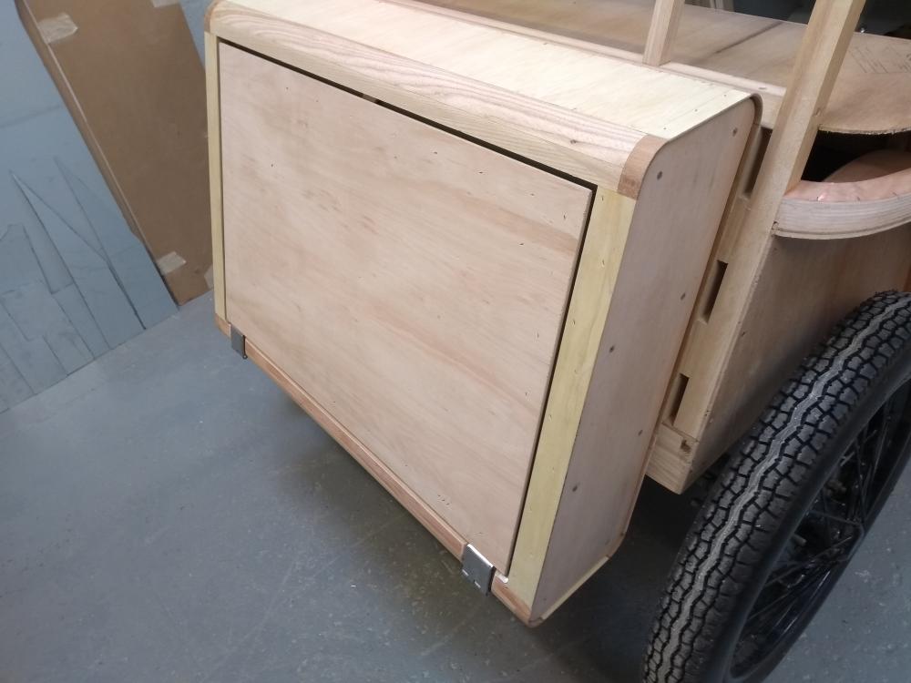

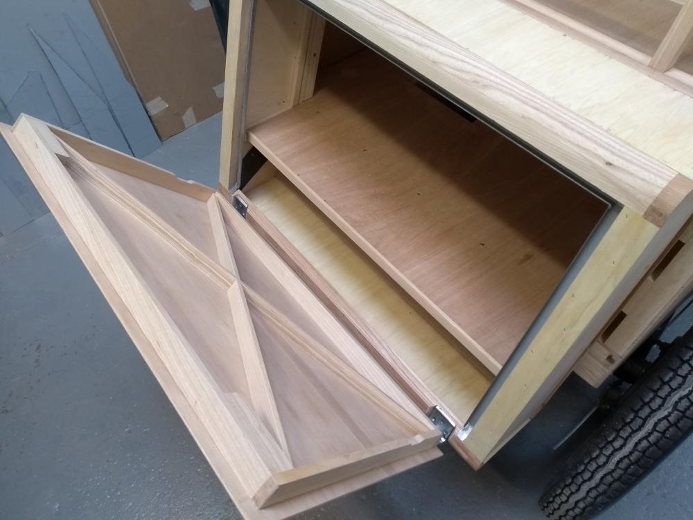

The boot has taken up far more time than I expected. The lid will carry the spare wheel and initially I had envisaged that it would be side-hinged. Despite finding a robust piano type hinge the weight was putting too much strain on the boot structure.
Plan B was to put hinges at the bottom; this was complicated because with the hinges fitted to the edge of the lid, the spare wheel caught on the underside of the frame as it opened. Eventually I ended up with elongated hinges. A bit unconventional but tidy enough I hope. The steel gulley took some time too. All in all a bit of a faff.

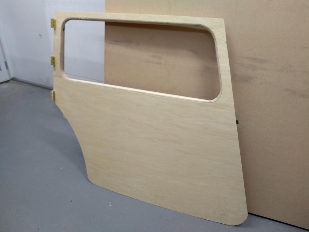

The doors were much more straightforward. They have been skinned on the outside and panels made for the inside.

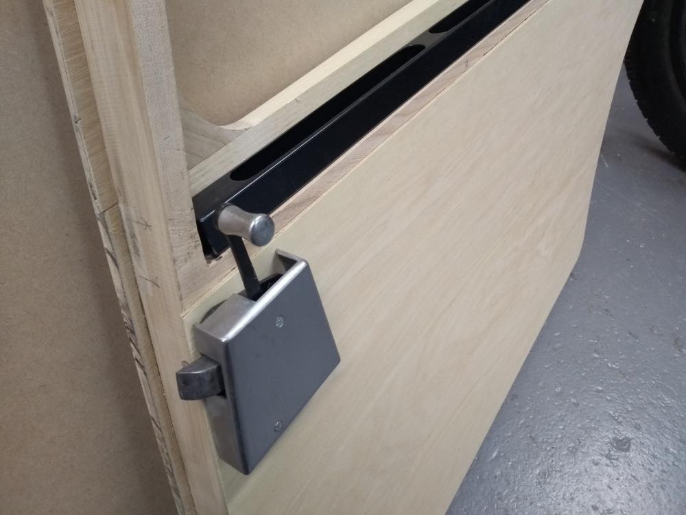

We found some Austin 10 door locks and I decided to make new covers to match the slant of the A-pillars. They will be nickel plated so my welding skills were pushed to their limits - no filler allowed!
I've also machined some rainwater gulleys from steel tube; they'll go underneath the window channels with drain-tubing down through the door bottom. There will be a hardwood trim holding the gulley and channel in place; traditionally I suppose it should be mahogany but I find the type you get these days to be quite bland. I've decided to choose the best looking pieces of ash and stain them a suitable colour.

I think the bottom-hinged boot lid is a much better solution; just add a leather strap each side and you can use the lid as a floor extension to treble the boot capacity!

I really like the idea of leather straps for the boot lid Mike. I spotted some in Derek's recent post (the lovely little Rosengart camionette commerciale). If one had any intention of using it with the lid down the rear number plate would need to fold - memories of my Mk1 Mini Cooper but I think to do so might just encourage too much use and abuse.
