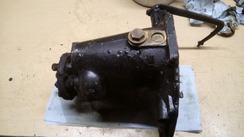

I did a quick inspection on the gearbox, innards looked very, very good but the old oil had solidified into a sort of gunge. I filled the box with Diesel, worked it in and around with a small paint brush, left it for a week or so and then connected the box to the lathe chuck and spun it over for half an hour before draining the resultant goo out. Now looks perfectly clean inside, no appreciable wear. I’ll change the oil several times in quick succession when it finally goes on the road.
Outside was cleaned appropriately but unfortunately, the comics who were involved with the “cosmetic” restoration in the ‘eighties had grit blasted the bottom of the box and then “painted” it. Took some cleaning and the box appearance is damaged from the grit in places….

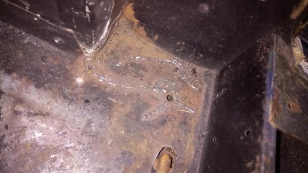

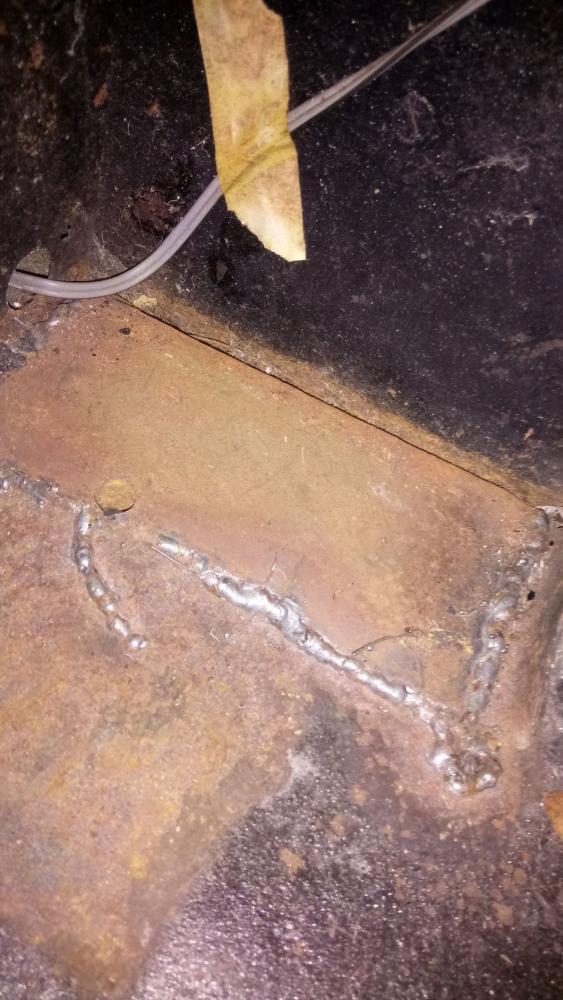

Now I’m working on the body shell. The inner mounting points were all OK but the outer four were badly stress cracked and the rear ones had been amateurishly welded with a MiG.
Fortunately, no rust to contend with; salt was not used on roads in pre-war days I believe, plus a lot of people didn’t drive in the winter. All four cracked areas of floor have been cut out and new steel welded in properly but the rear mounts had cracks that went underneath the seat box rear rails, which had to be removed from the floor so that I could get at the damage.
These patches have taken ages, it's very difficult to fold myself inside the body to do some work, only to find I've left something on the bench and I've got to get out again and fetch it.... It then takes several walks round the garden to straighten my back out before folding myself up again inside the bodyshell....

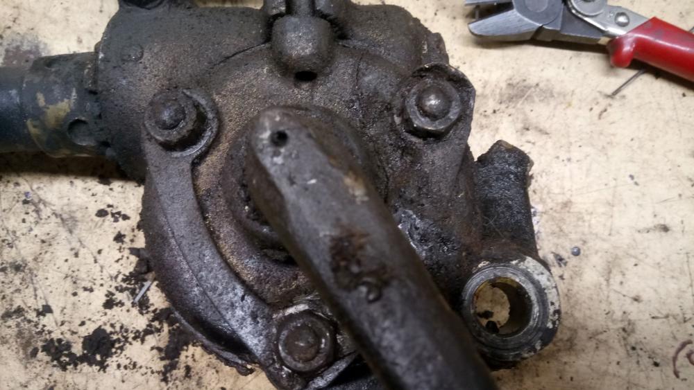

Got the steering box down from the attic. I hadn’t noticed when I stripped the car down but the steering box is riddled with cracks and…..
….the bodger has been here!
The cracks probably came from the accident but the Chummy steering box casting was also cracked 10 years ago when I rebuilt that car. Are these early steering box castings particularly vulnerable??  I didn’t have a spare vintage one at that time so I rebuilt the innards and column into a Box saloon type casting. I think that the angle is slightly different, it was a struggle to fit the box into the Chummy but I wangled it in eventually.

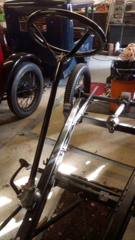

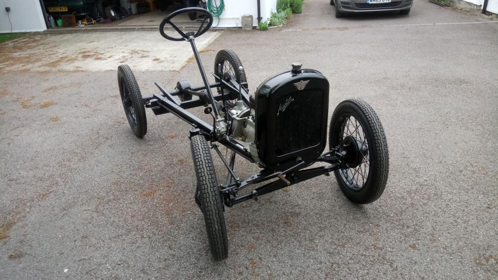

Glad to say that the chassis (apart from the engine) is pretty much complete now. Finally fitted the handbrake bits this morning and pushed the rolling chassis outside for a photo call.
The radiator is just placed on to give me a sense of completion!
Engine is my spare mag engine, it ran in the chummy quite successfully for a few years until the definitive chummy engine was ready.

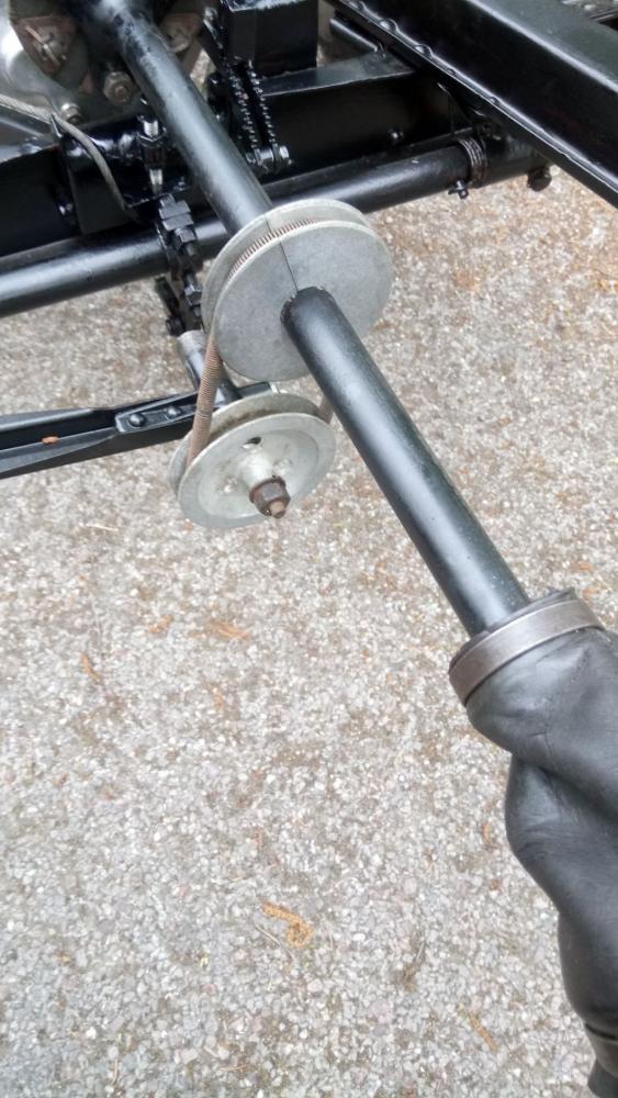

Showing the spindly speedo drive: someone wanted pictures of this device a few months ago?
Surely it’ll never work, will it?

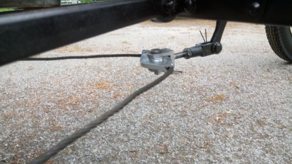

The cross shaft had the remains of a brake coupling lever on it. I don’t know whether it’s a “Bodelo” or whether other devices were available.
I made up the bits that were missing and coupled the front brakes with a separate cable. I think I mentioned this before and a couple of people said the device was not much good. I can’t see how it differs from an early coupled brake Austin 7 and I think with careful adjustment, it should work quite well. We’ll see when I get it on the road.
