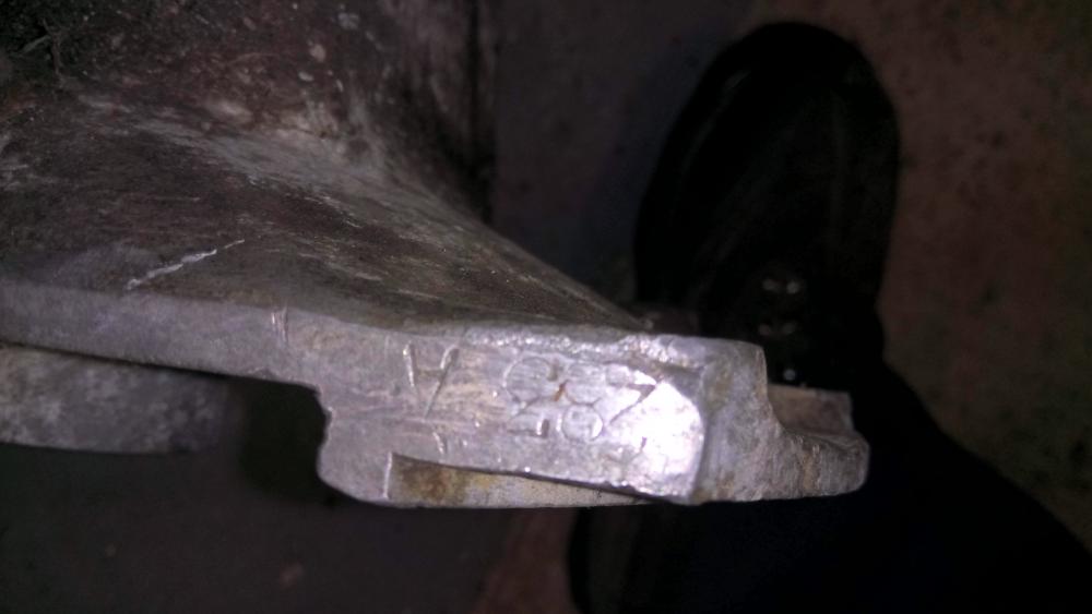

The number on the gearbox is stamped on the near side front "ear" of the bellhousing on early boxes.
This one is 283A which translates to 10283 (assuming the missing zero), which is 1925 I believe. The box has XL + 3 digit part numbers all over it.
The number was stamped above the output shaft on later 3 speeds.
SM 4020 may be a casting number or foundry reference??
