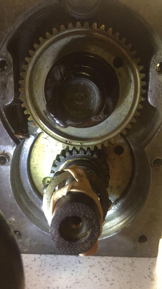

Blic magneto - no discernible difference when advancing or retarding...
Alan, I think you are on the money with your comment, thank you.
With help from Robert, his very old magneto book and WhatsApp, I think I have discovered a miss-time inside.
Armature gap at 2.8mm before adjustment...
After one tooth adjustment...
With the single dot aligned the timing hole for the pin now also aligns perfectly - which it did not do before.
I will refit tomorrow and report back, fingers crossed and many thanks for everyone’s input so far.
