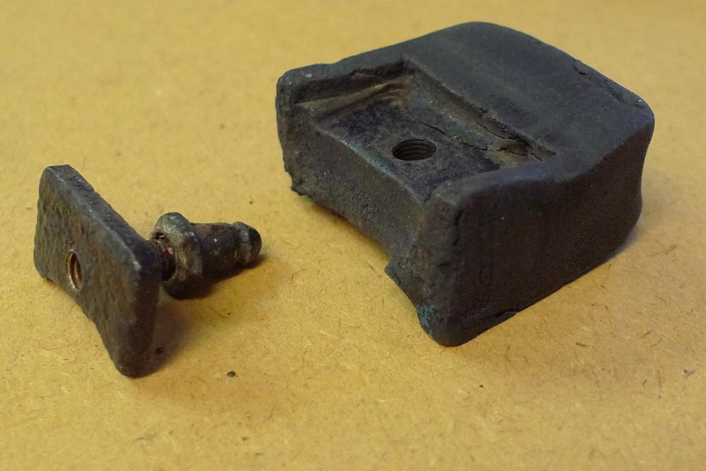

Robin,
This shows an original rubber, slightly misshapen with age and use.  It is fitted to the bracket simply with a "lift the dot" nipple on a long screw thread, screwed to the 1/8" thick shaped threaded steel plate shown.  The rubber is recessed to take the plate.  Long shank "lift the dots" are still available, I had to buy a small pack to get the two I wanted so I have a few spares.  PM me if you want them.
The "lift the dot" on the photo is a short one and for illustration purposes only.
