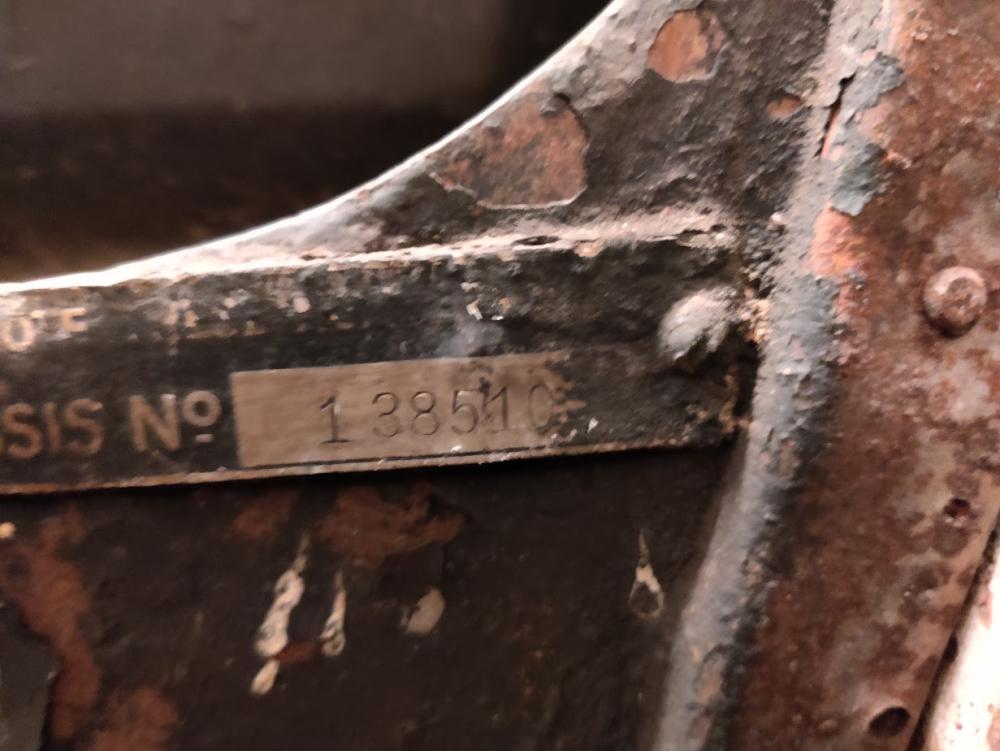

The chassis no. is 138510, does that mean it's a 1931?

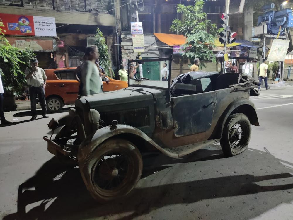

That is a remarkable find.  I believe it is an AG tourer from around June 1931.  Although many refer to these cars as Chummys they are technically Tourers. Home models would have had 19” wheels although export models may have had 18” wheels.
From my meagre knowledge the car looks to be very complete.

Your images do not show on my screen, but from your description yes. it is an AG tourer (chummy). The chassis number dates it to June/July 1931. At that time all Sevens, home market or export, were fitted with 19" wheels.

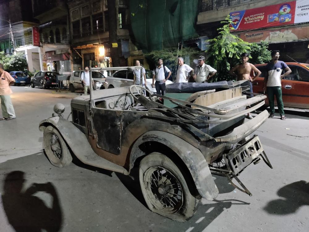

It might be worth deleting them and then adding again as they really do look lovely, only surpassed by the look on the faces of the on lookers who don't seem to know quite what to make of it.
From my time working over there, albeit a few years ago now, the thought of negotiating and weaving around Hindustan Ambassadors and Marutis in an Austin seven would scare me silly.

Whilst I'm not much of a rivet counter I'm with Howard and that looks like me to be an AG rather than an AF. And a very complete one at that.
Needs a bit of work but it will be worth it

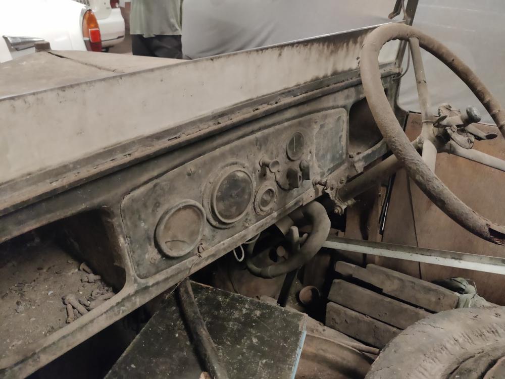

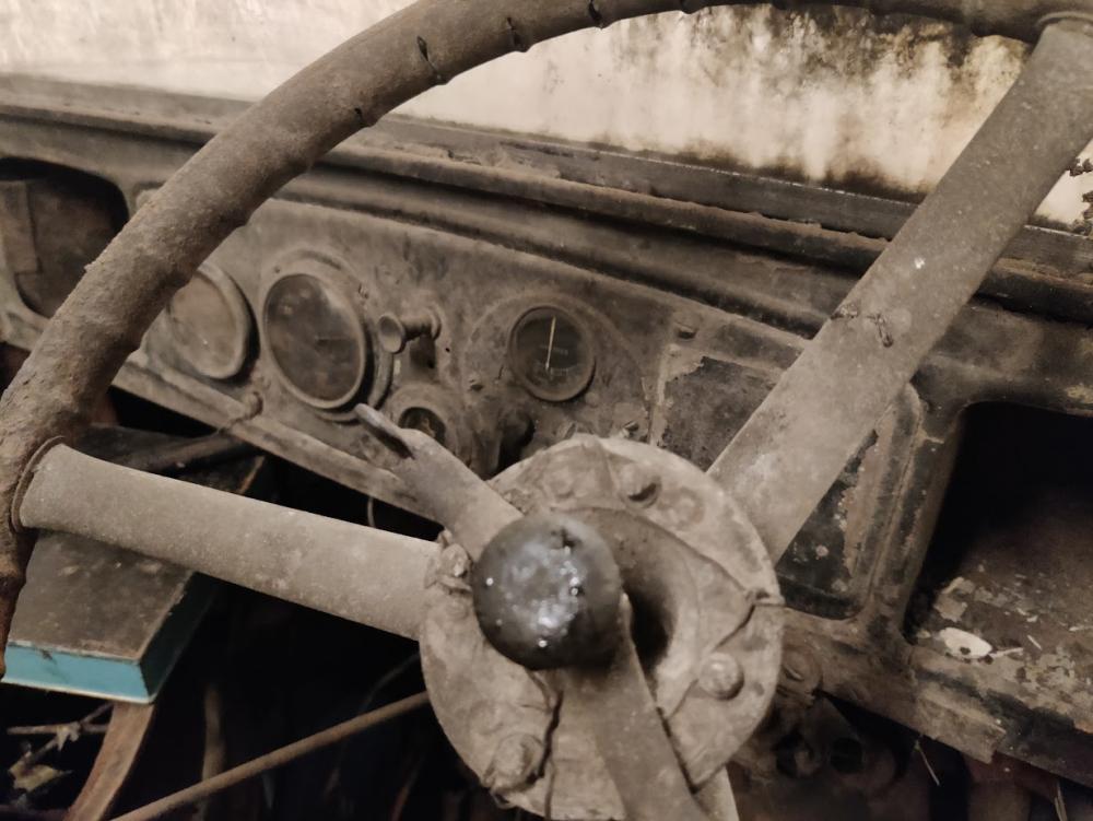

Where is the starter switch? Or is it a foot starter since the starter motor is ahead of the gear stick under the dash.
Is it supposed to have a separate instrument panel lamp or are the gauges backlit?

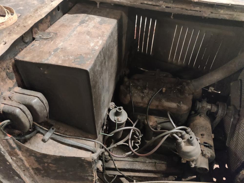

What carburetor should the AG have?
