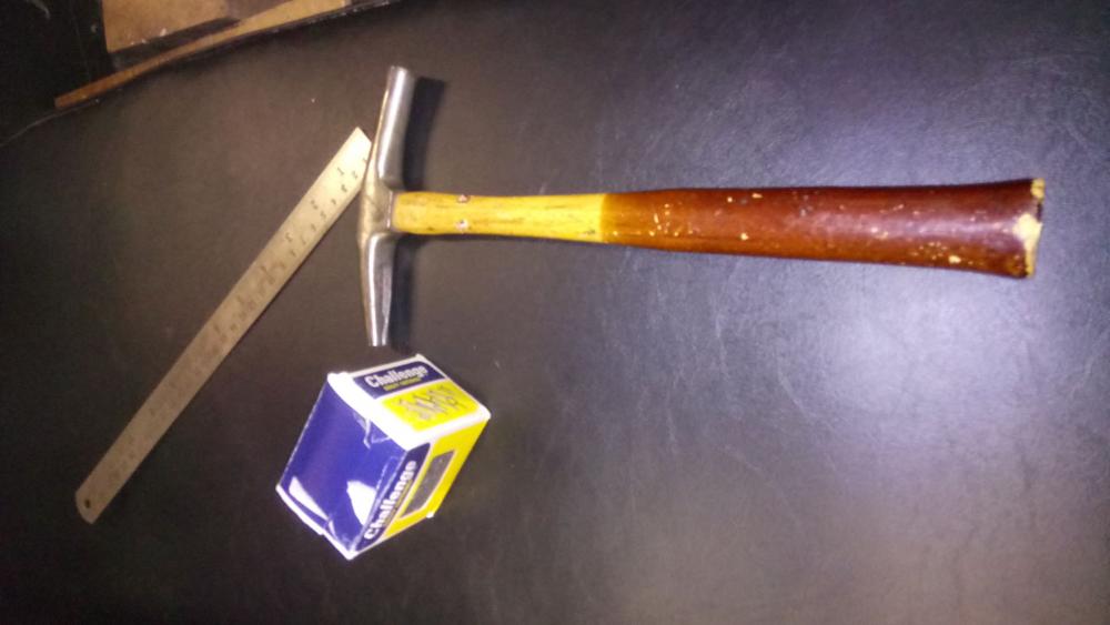

Here are the tools of the job, magnetic tack hammer is a delight to use, thoroughly recommended.

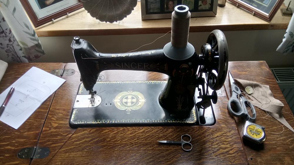

The sewing machine is a 1911 Singer 66K, bought from a junk shop for a few quid forty years ago. I restored the machine and used it extensively in the eighties and nineties to restore a succession of Ruby and Box models but it hasn't been used much since. It needed a good oil up and a new belt as well as converting from a back clamp to a side clamp machine so that I can use a zipper foot to produce piping.
