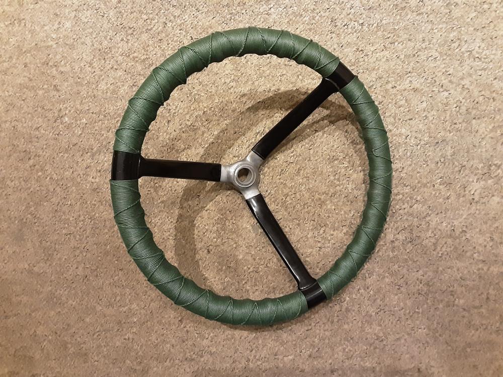

As shown on stringing a steering wheel thread. The wheel is finished.

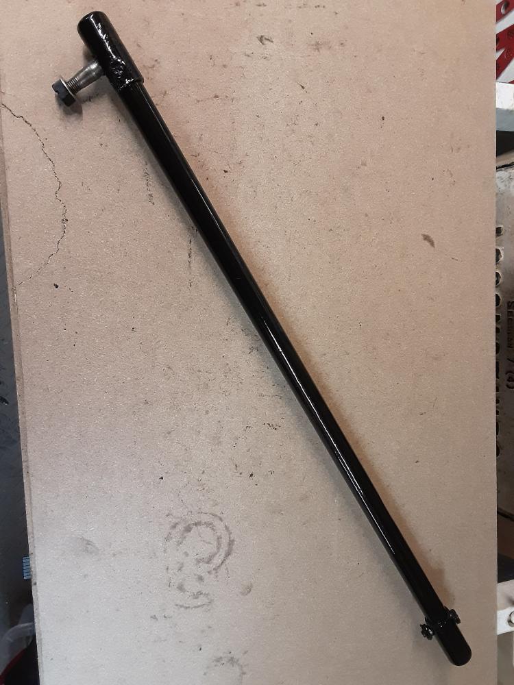

The draglink is now fully rebuilt.

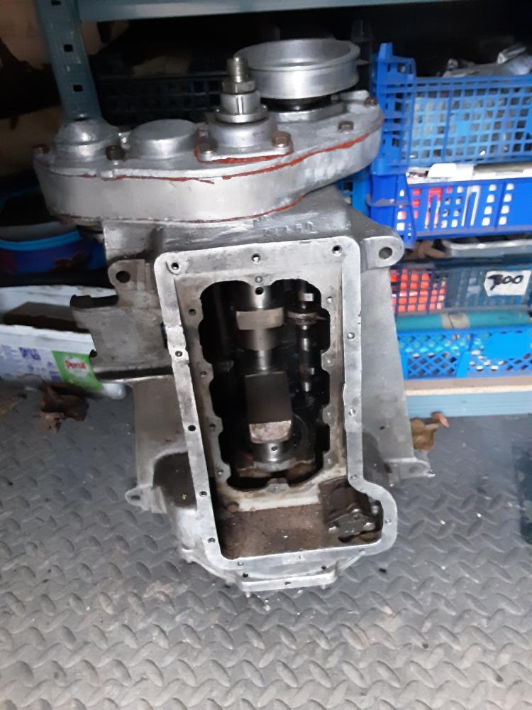

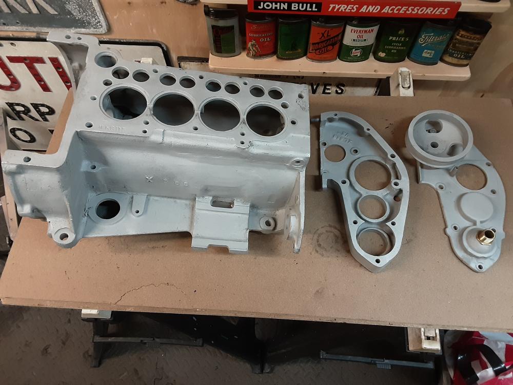

I've been working on the engine over the last couple of weeks.
Everything is now stripped out, and cleaned. Ready to build what I want.
I can't start the build up until the new year, as I need to get the crank and flywheel ballanced.
So I've been working on the front timing cover, it was already drilled and tapped on the mag drive bearing. But I dont know what for. The thread was to small for a rev counter. So I've centred the thread and tapped it to take a rev counter drive.
See below.
The engine had an early coil engine camshaft. Ground for road and trials. So it can take a fan pully on the front.
That's very handy for me, as I want to fit a bottle on the front of the crank. But keep it splash fed.

hi gene,
the crankcase is not perfect, several repaires, but they all look good repaires. there are also a couple more to be made.
i dont know about the hole for the idle gear, do you mean drilling through to the engine for oil supply.

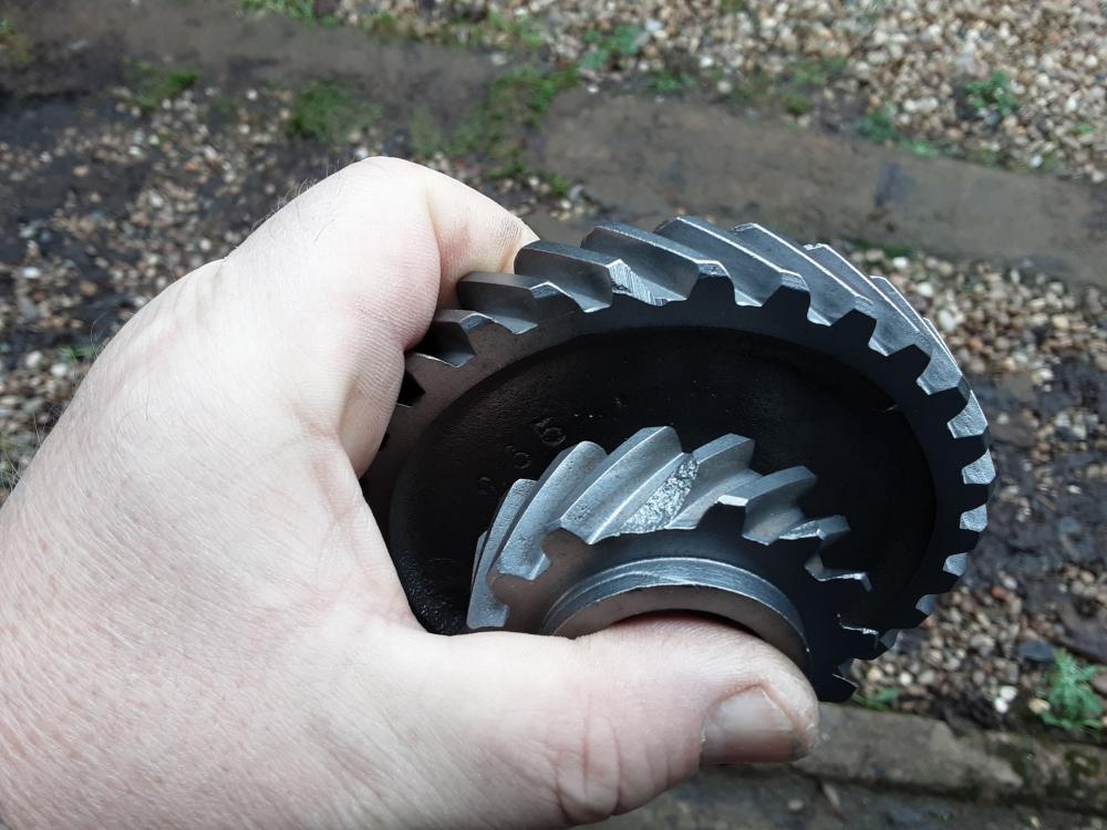

These were the gears.
The cam gear is usuable. But I have better one. Were the teeth haven't had the chips ground off.

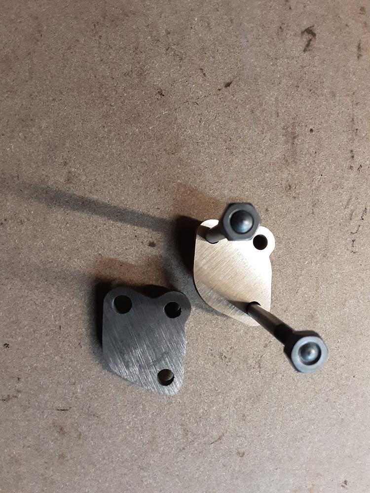

In the same pump, the base plate holes were oversized.
So I'm using the one with the bolts in.
Not sure if the picture will show it.

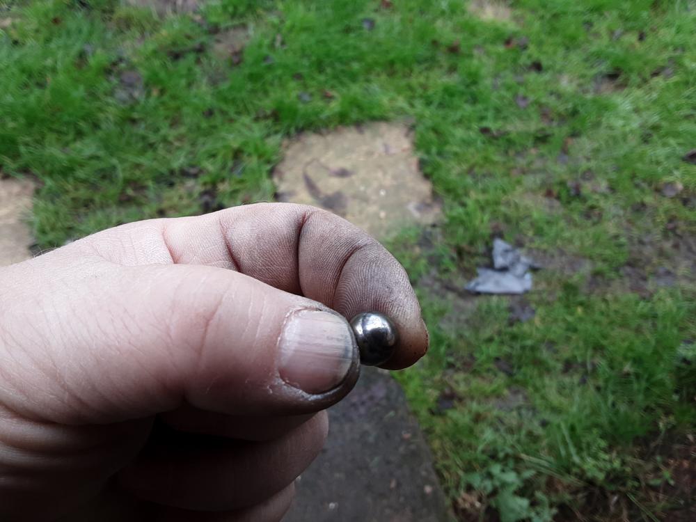

But here is the relief valve ball, removed from the engine. There is a huge wear step you can catch your nail in.
So for £1.50 a new ball and spring has been fitted.
Always always do your own checks.

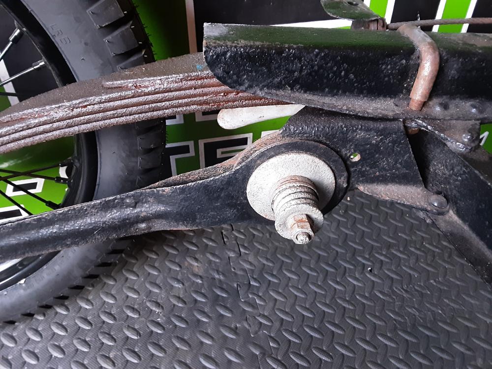

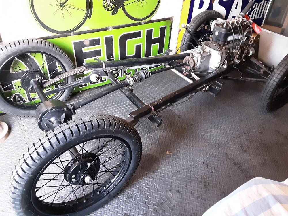

Had the chance to remove the body today, and start stripping down to check the condition of individual parts.
It's good and bad from what I remember.
There is a good area of corrosion on the chassis behind the column. Although I should be able to fill this with weld.
It's good to see the hole in the rear damper mount that shows it had Hartfords originally. As I'd like to copy the original front Hartford on the boulogne car as well.
