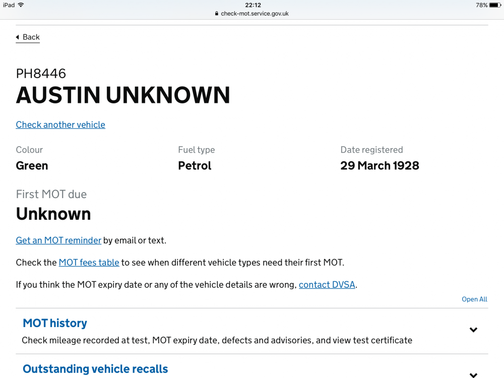

Now back on a 1928 car
Yes, Green, Petrol and registered 29th March 1928.
But it's now on Chassis number 7961, Car number A1-7961.
