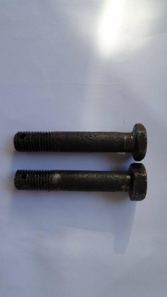

What means "bottomed out" please? Not sure I understand that! (Silly frog!)
Joined: Jan 2019 Posts: 1,625 Threads: 22
14
Location: Bala North Wales
Renaud,
A bolt has a threaded portion at the bottom, followed by a plain shank up to the head., unlike a setpin, which is threaded all the way up its length.
A bolt " bottoms out" when one puts a nut on the reaches the end of the threaded portion without putting any tension on whatever the bolt passes through.
Hope this helps (and no, you are not a 'silly frog' - English is the most awkward of languages with lots of obscure idioms!)
