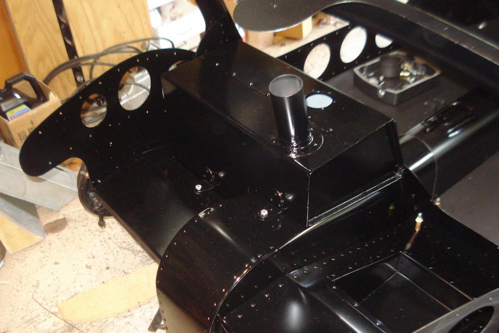

Hi Ian,
Thanks a lot for sharing your work with us.
May I ask what paint you use on ali please. Any primer? Your black looks beautiful. Btw I do like your green rad surround too.
Renaud (in very windy Brittany)
#98
Hello Renaud, long time since I have seen you here welcome back! I use a black etch primer on Aluminium which is important to get it to stick, even so scotch brighting the entire surface first is important. The etch primer is also thin enough not to loose detail as you would with a modern high build primer, the black top coat I use is a PPG two pack, I add differing amounts of flatting agent to the paint depending on the level of gloss I require. For example the floor pan and petrol tank have 25% flatting agent and the wheels only 10%, to my eye full gloss is just too shiny!
I am actually wondering now if you were looking at the etch primer before I had applied the top coat?
#99
Hello ian,
Thanks for the welcome back!
I was referring to that kind of splendid finish you achieve there:
[Image: attachment.php?thumbnail=7679]
Apart from your skills at metal forming where I'm a lot far away (behind!) I'm also a lousy painter but I always think that I can get better!
I fear that your paint products could be difficult to get here maybe.
That is just the etch primer Renaud, I could probably replicate similar in the top coat with something like 50% flatting base, however I have gone for a 25% satin finish, the photo actually makes it look shinier than it is! I would have thought anywhere that sells to the Automotive refinishing trade will be able to assist, unless the EU have banned these type of products in France they are commonplace in the trade.
