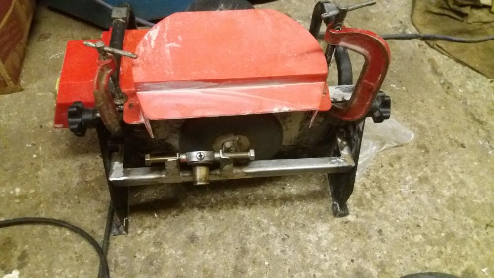

Hi Jamie, picture of first prototype. As you can see, crude but worked well. You also need to control the feed of the follower to the grindstone in order to keep an accurate radius. Easily done with some threaded rod and a nut.

Jamie,I use a Clarkson tool and cutter grinder to reprofile followers which also means I can redress the wheel easily,and yes £25 plus post providing they're not for ebay re sale !
Reprofiled followers work well with an original profile cam.But if you are using a reprofiled camshaft ask the cam man which radius followers you should use. Using either will require shortening the bronze tappet guides inside the tappet chest.
