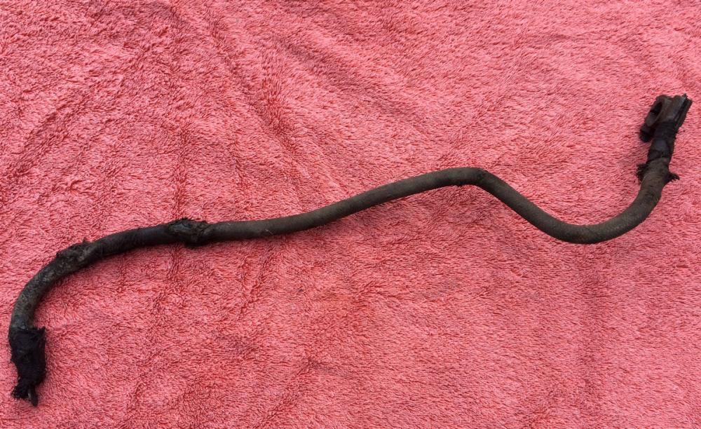

Below is a picture of what I understand to be the factory original cable from the battery to the starter, condemned because the insulation has naturally broken down over time. The cable is of a decent thickness and the terminals at both ends appear to be soldered. I'm interested to know how others have tackled the business either of creating good quality battery cables, or if there are any recommended specialists who can supply a quality finished product to order. Many thanks.

Any decent auto electrician should be able to make up a cable to whatever spec you want. Jeff's specs look good. I would only crimp the terminals on, with the proper crimp tool that looks like a big set of bolt cutters. A proper crimped joint is much better than a poorly crimped and soldered one. After crimping you can cover the connection with heatshrink. Use the kind with glue inside it to get a waterproof connection.
If you solder them you're more likely to get corrosion in the joint from the fluxes (if you really do have to solder use proper electrical solder, not plumbers stuff that can have very acidic flux). Also the heat required will anneal the copper lug and copper wires making them softer and the point at which the solder wicks up the cable you get a stress point that can eventually break if the cable can move about. It's also hard to do without melting/affecting the insulation. Certain industries don't allow crimping and soldering of the same joint, notably space and aviation.

I agree with Jansens comments, have done a lot of Marine and Truck instillations and NO Soldering.
Main reason because a crimped joint spreads the individual strands and they make a much better contact .
were as a soldered joint can be what is termed a Dry joint ie the solder is not making a good contact either between the strands or the fitting leading to over heating.

I was always told (when working as an electronics technician) that the reason you don't use soldered/tinned wires under screw terminals is because the solder is soft and over time it 'creeps' and the connection will come loose. Not sure how accurate that it but definitely at a holiday job I had doing stuff for a military application years ago they were strict on what we could and couldn't do and crimped and screwed connections couldn't be tinned or soldered.
Saying all this I think a decently soldered connection will work perfectly fine in an Austin 7 even if not 'technically' correct. Practically it should work fine if the solder joint isn't a dry one as Colin says.

Another disadvantage of soldering is that capillary action with molten solder makes the flexible rigid at a point where it may well be subject to mechanical stress. This can lead (eventually) to a fracture just beside the soldered section, particularly in cars which have high vibration and subsequent loss of loose parts...
A hefty crimp is a far more appropriate method.
