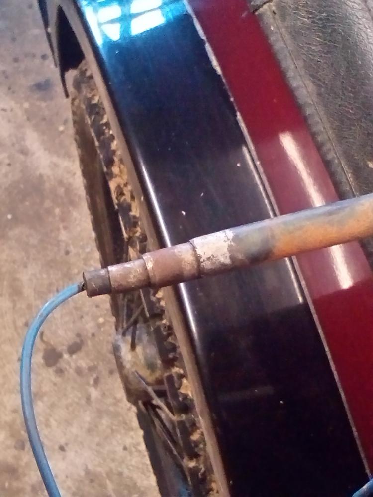

Stuart - I'm presently thinking that I'll persevere as is until I come across another SWB saloon steering column so I can strip things with no time pressure.
At present, every little problem that arise results in a strip down that seems to have grave consequences (i.e. things beyond the immediate environs of the former problem... )
Anyone got a cheap working steering column?!

I've only done this once and it was a very long time ago so I can't remember exactly but I think Stuart's correct.
16
Car type:
But presumably it is going to need resoldering/brazing together again once replaced.
So even if you CAN get the thing out in situ, it would seem it would need to be stripped to get it together again properly?

Dad was faced with this problem with the chummy some years ago. Dear Mick Kirkland supplied a replacement stator tube via a scrap steering box. Neither father nor I have had any success in messing with the black art of steering box assembly or adjustment. So I think dad got Aled in Wrexham do it as a swap for a rubber mounted high frame crankcase.
Joined: Oct 2017 Posts: 1,631 Threads: 61
9
Before attempting to unscrew the big nut securing the stator tube in remove Austin's enormous pop marks by either drilling or turning so that all the damaged metal is removed. then you may attempt to undo the nut, it will undo about 1/4 turn then the whole lot turns so refit the steering tube and the outer column and screw the outer column down to remove all end float, this will stop the stator tube turning. DO NOT use grips on the stator tube if you intend to reuse it, I once spend many hours straightening one out which was the cause of very tight steering.

Dave, a proper engineered solution, I'm ashamed to admit that I tried Mole grips and ended up with a stator tube with more flats than a threepenny bit (pound coin in this new decimal parlance).
Regards from the creative county - Staffordshire
Stuart

I had trouble clamping the Ignition/Gas plate to the stationary outer tube in the column. I cured this by inserting shim to allow the clamp to grip the tube.
Are you sure that this isn't what is happening in this case?
The innermost of the three tubes is the hand throttle, next is ignition and the outermost is the stationary tube to which the plate is clamped.
This can be checked quite simply.
First remove the two levers on the bottom of the column. First note their position which I suggest is done with both levers at the lower end of their travel. Then slacken the clamp bolts and the levers willcome off.
Also slacken the clamp for the Ignition/Gas plate.
Once this is done the plate and 2 inner tubes can be pulled up the column an inch or so. This should reveal the outermost tube to which the plate should clamp. It should protrude by the thickness of the plate and should not be loose.
If it doesn't protrude or is loose then the outer tube needs to be replaced as already described.
If it does then the clamping of the plate is inadequate. I used shim to get a tighter fit. Don't over-tighten the clamp, it will split the plate.
There are screws in the levers that tension the springs that grip the plate to stop the levers moving. If these are unscrewed and the springs and friction blocks removed the plate can be separated from the levers which makes it easier to fit the plate onto the the outer tube.
Once the plate is clamped firmly the two inner tubes can be pushed home and everything done up.
