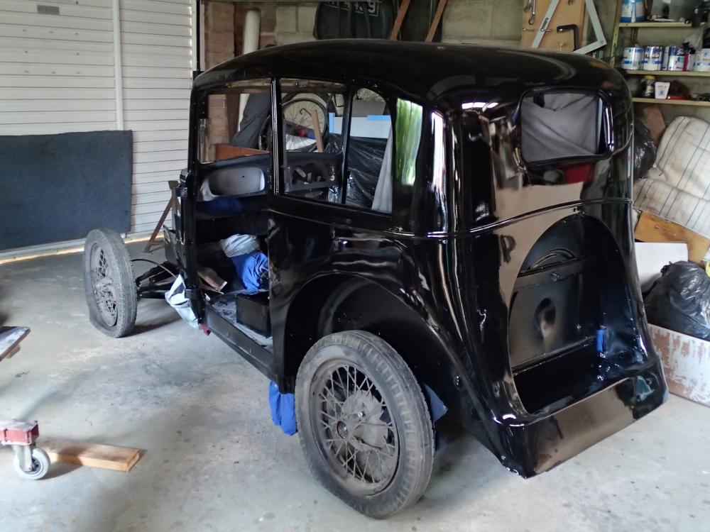

Geoff - At last I can make a start on the body.
Foot recovered and Ruby body attached to the Rotisserie/Tilter as shown below.
