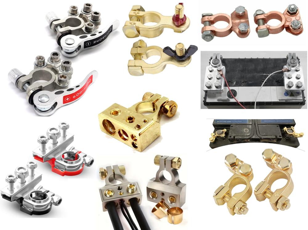

I spent what I hope will be a profitable day making much thicker 350/400 Amp battery cables for the '30 Chummy. By the way, have you seen all the amazing new battery post clamps now available? They come with terminals to hold input and output wires without the need for spade ends and/or various types of terminals to wire in accessories. I don't know why one would need a quickly detachable type.
