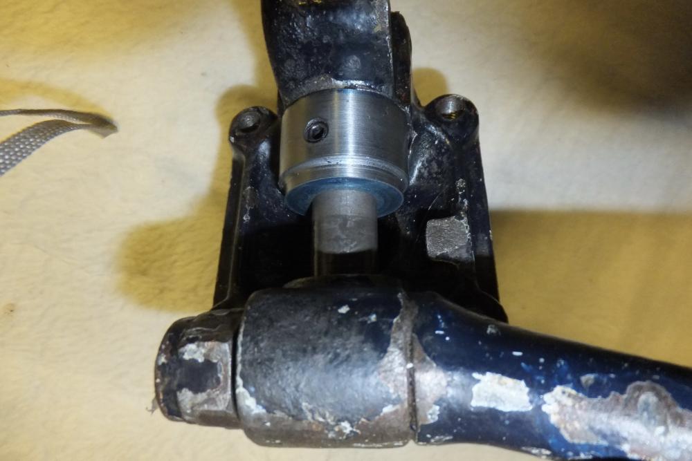

From the reading I've been doing, I've decided to go with a modified front damper, immobilising the one side, to help locate the front axle better. I turned up a nylon bush, and then a steel shell to go round that bush which then press fitted, and welded for good measure, into the end of the damper arm. I also decided to go with a bronze centre bush instead of the nylon option to help further that rigidity.
[Image: 37f2539ab0ca.jpg]
The damper is now assembled with new friction discs, centre bolt and spider washers, ready to go back on the car.
