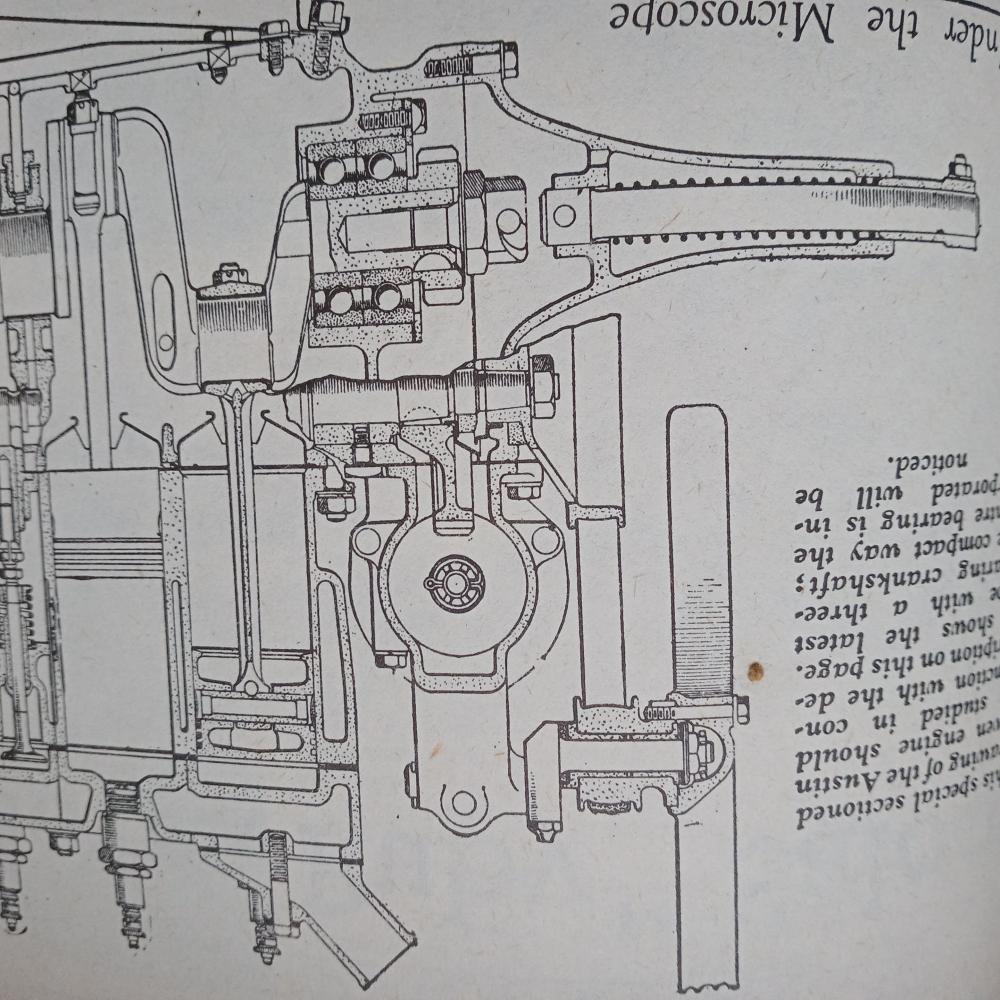

     Here's a drawing of the starting handle for a 1934 engine showing no seal. Due to it's design the handle locating boss and it's housing are prone to wear because of water causing corrosion aggravated by road dirt and being bounced about on the front of a Seven. All of mine have needed rectification due to up to 1/4” of slop by bushing the housing and when done were quite a neat fit which soon became slack due to use. To stop water and road dirt entering the engine I have since found an 'O' ring which does the job and provides some resilience between the steel handle and aluminium housing. With the Ruby being longer I suspect the problem is worse and my mod would reduce oil leakage when facing down hill.

I don't know why the drawing is upside down and note the spring chamber drain hole which aids dumping oil when facing down hill.

(20-01-2025, 01:25 PM)Dave Mann Wrote: I don't know why the drawing is upside down and note the spring chamber drain hole which aids dumping oil when facing down hill.
Thanks are you saying that the bit I have highlighted is a drain hole back into the engine sump?

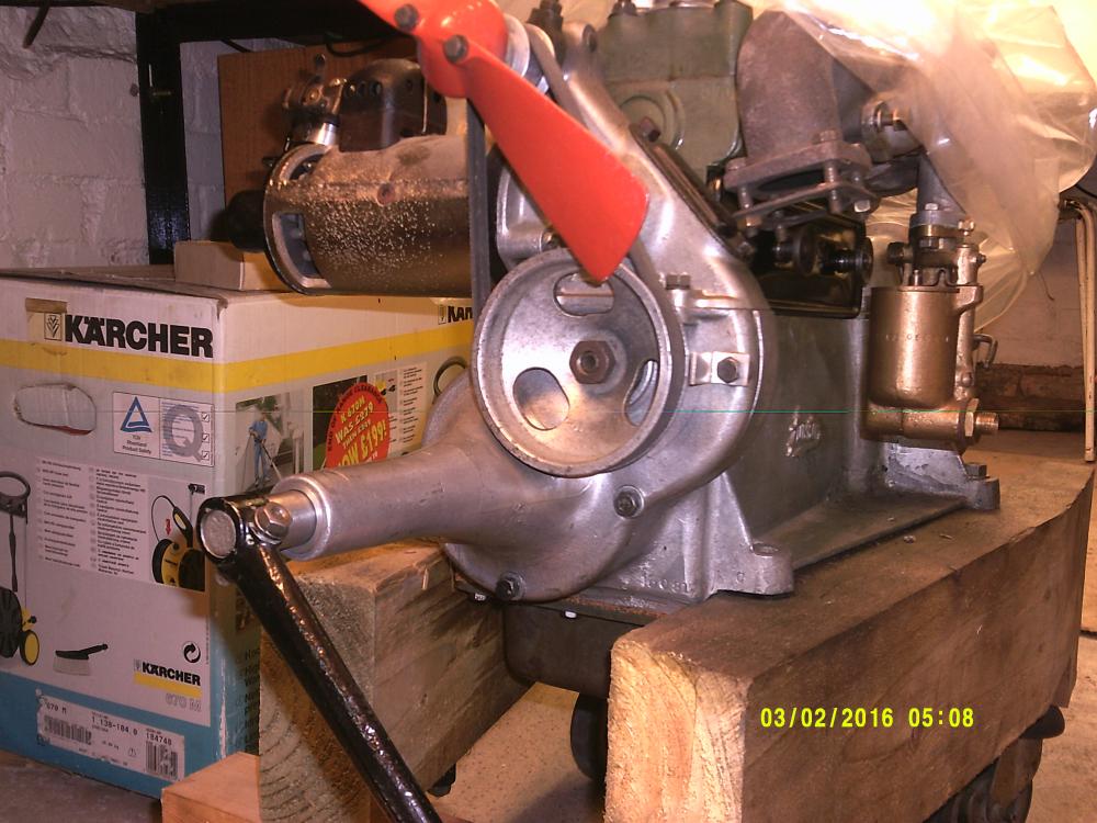

If it helps and you can see. This is our drive
.png   Starting handle pic 2.png (Size: 521.69 KB / Downloads: 262)
If you click on the image it opens in a new tab the right way up.

Yes Stephen
