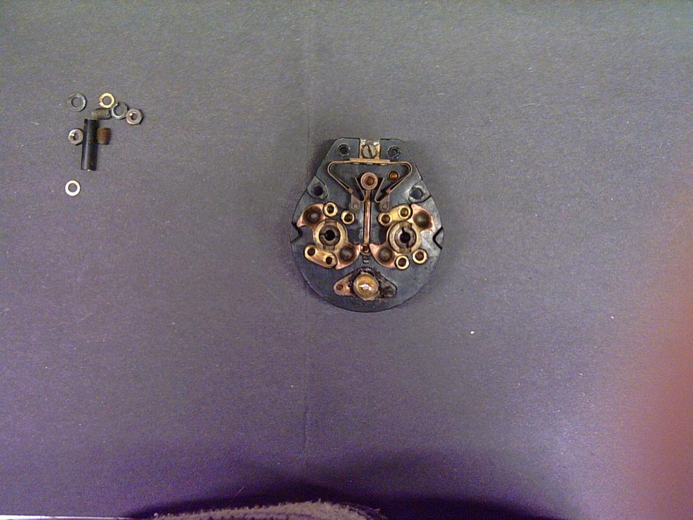

Ah that means:
1) either there is a wire missing between the dynamo and the switch panel or
2) there is a pair of rollers in the switch panel which are operated by moving the left switch to winter or the right switch to put the lights on      which close contacts between D and F to give winter charge. This suggests that the contacts are dirty or the rollers are missing.
