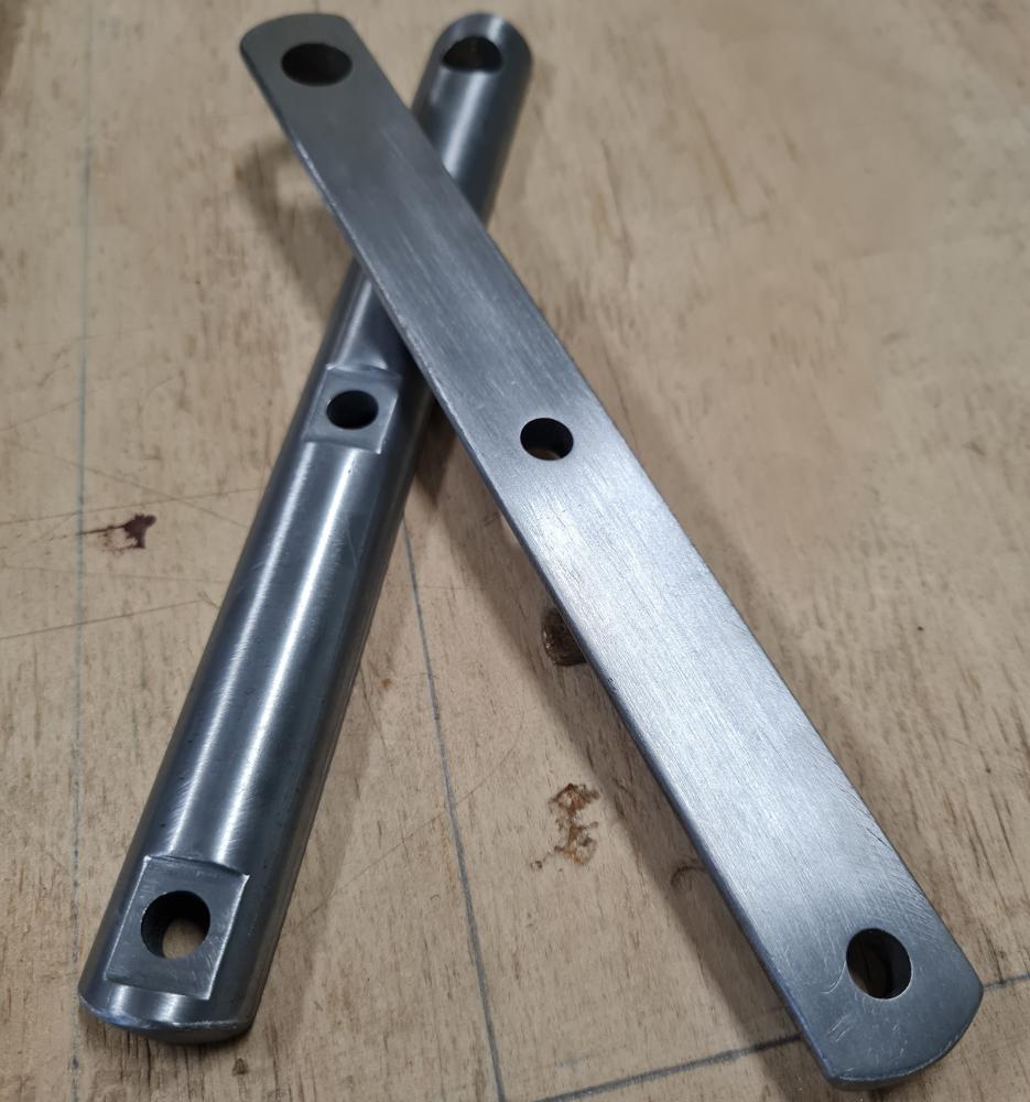

This is the half round windscreen posts that have been cut in half and are being filed to shape. I don't have a milling machine so I just cut a piece of round stock in half with an angle grinder and then shaped it with a file

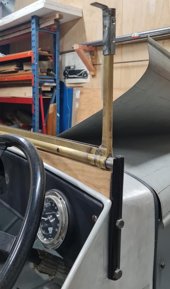

Here the full internals of a folding screen can be seen complete with pivot locking wedge and "slug" that allows the wedge to expand and lock the screen. quite a clever system.
The finished result ready showing the windscreen frame soldered up and side posts attached. Spacers are still yet to be fitted and hood brackets need to be properly attached.

"This is the half round windscreen posts that have been cut in half and are being filed to shape. I don't have a milling machine so I just cut a piece of round stock in half with an angle grinder and then shaped it with a file"
Your file work is excellent !   Smile
