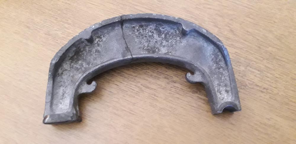

I’ve just finished fitting new linings to some 1 1/4 shoes to be used as a spare set.
Imagine my annoyance when I discovered this crack!
.jpeg   IMG_5083.jpeg (Size: 109.92 KB / Downloads: 228)
I can only think I’ve been a bit too heavy knocking out the old rivet or with the air hammer fitting the new rivet.  Luckily I have a spare shoe…..but it got me wondering how serious this crack actually is?  It won’t progress across the shoe further than the rivet hole and is possibly not too highly stressed.
Any comments before I chuck it in the bin?

Would I tell a "client" that was OK? - no, because the potential liability isn't worth it. If a shoe did break up under load - however unlikely that might be - things could get nasty.
Might I use it temporarily if I didn't have a better one? I guess I might.
Do you have a pal who can weld aluminium?

A lot of them do this these days, they are nearly 100 years old and it is to be expected.
I just bin them, there are still many second hand available and Jamie sells brand news ones at a very reasonable cost.

In that case, and for that price, it would scarcely be worth trying to repair a damaged shoe.

I have one here in my 'Black Museum' that came from one of my cars a long time ago. It had actually broken across the full width so it was in two parts and then had been very neatly glued back together with epoxy glue by a previous owner!!
RE: Brake shoe crack - Robert Leigh - 02-05-2025
A welded aluminium component will have unseen stresses in it. I would only weld such a component as a last resort.

If I was a cruel man I'd suggest that's a good reason not to use an air hammer on your brake shoes
RE: Brake shoe crack - Howard Wright - 02-05-2025
(02-05-2025, 04:48 PM)Charles P Wrote: If I was a cruel man I'd suggest that's a good reason not to use an air hammer on your brake shoes
Yes
Very cruel. But probably true.
RE: Brake shoe crack - Duncan Grimmond - 02-05-2025
I'd agree that an air hammer can be a bit too insensitive for that kind of work on a component which could be 60 years old...
I know it can be tricky but I'd always be tempted to set the rivets by hand.
