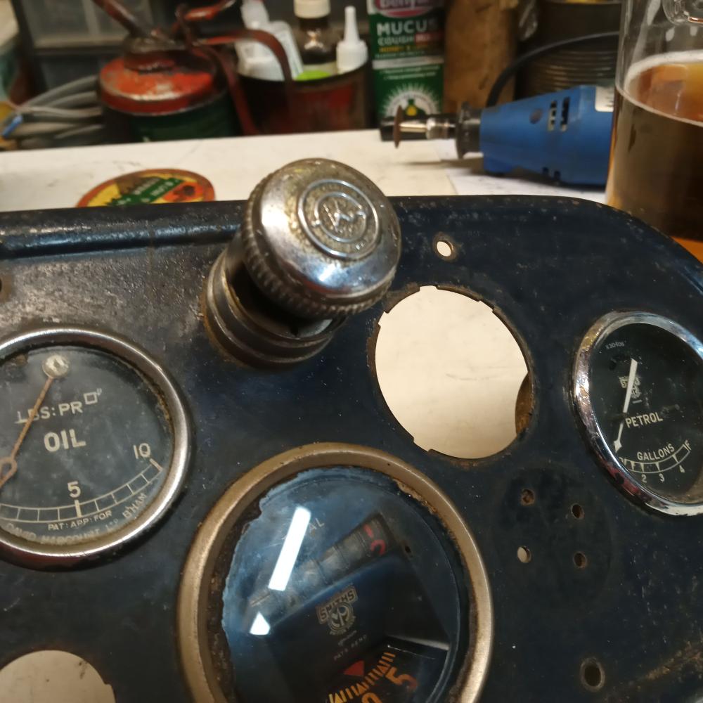

This 1934 tourer is missing the internals of the dash lamp does anybody know what should be in it?

RE: Dashlamp - Dave Mann - 17-04-2025
Many thanks Chris, your first photo shows the only bit I have on the tourer which is knackered but a friend gave me an RP dash with a good one which I have extracted to fit in the tourer. The only only other internal item I have is the spring but with your photos 2 and 3 I now know what I need to make.

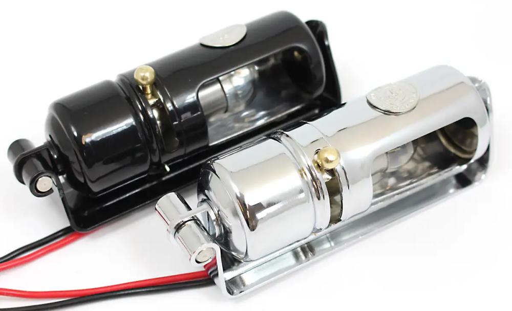

Well done, David. That's an excellent reconstruction. By the way, RR, as you all know, used to work on their switches to make the action as smooth and grit-free as possible. Every example of that Lucas dash lamp I've encountered appears to have been engineered to produce precisely the opposite result!
I thought one of these lovely-looking ones might be better, but if anything, they're worse. They flap about on the hinge, the switch is hopelessly stiff, and the rotating sleeve is just pushed on with no 'pin and slot' provided to keep it in place.
