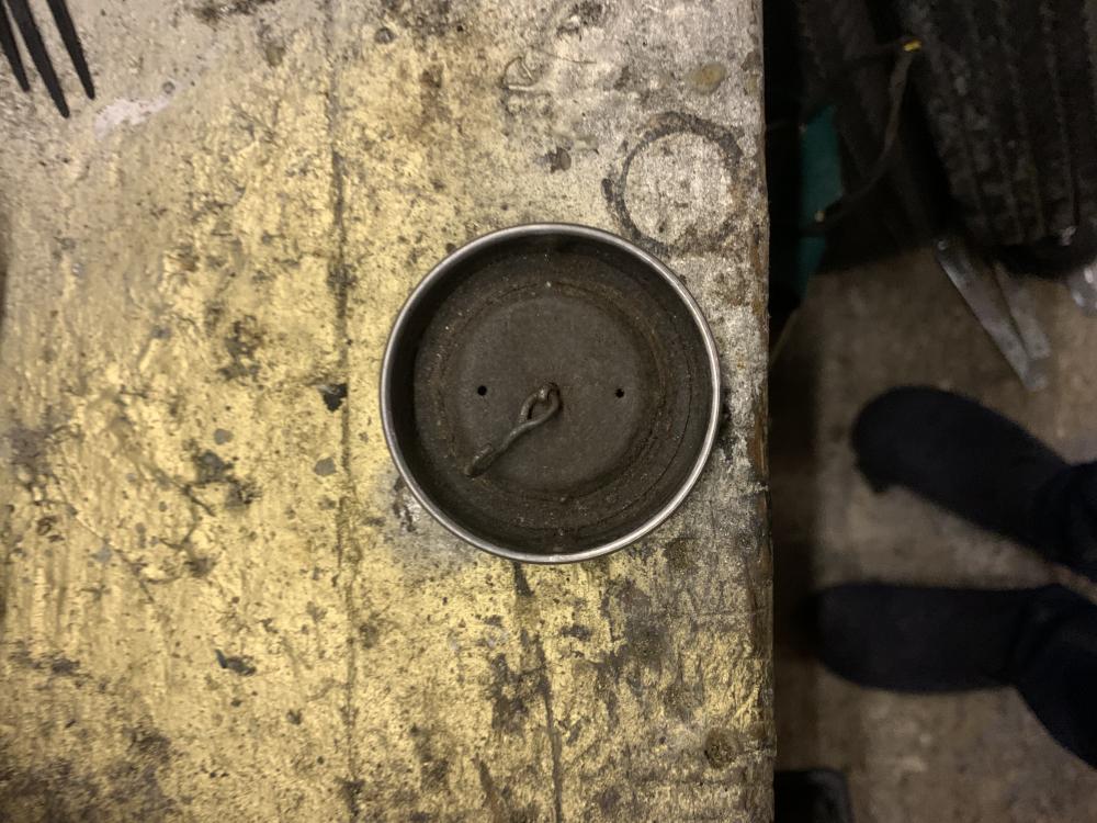

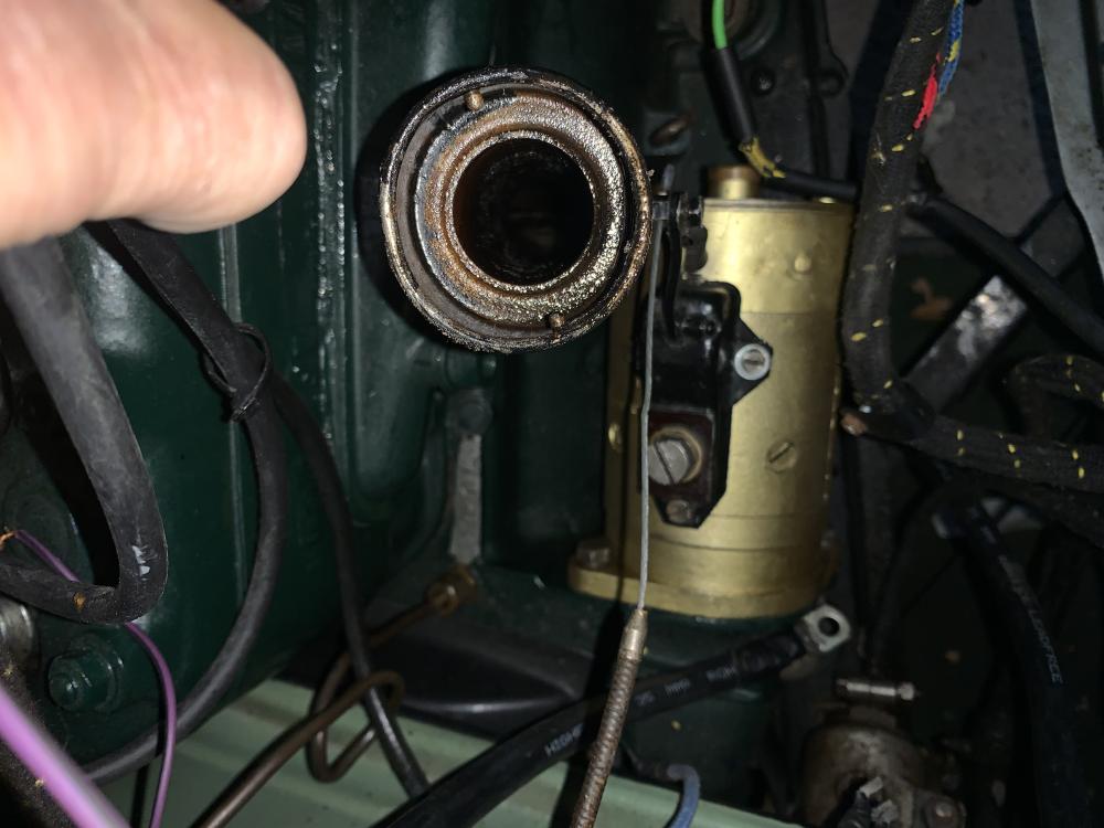

I’ve got a couple of of caps neither of which appears to fit with the fuel tank or engine
Any ideas what I have ?
RE: Fuel Cap , Breather ?? - Ivor Hawkins - 27-11-2022
I think the top one is an oil filler cap which is missing its spring clip....the bottom one could be missing its clip too!
RE: Fuel Cap , Breather ?? - Mike Costigan - 27-11-2022
I think the bottom one is a Ruby petrol cap, which should have two small pins to secure it; it looks like your filler connection has been modified to take a different cap.
RE: Fuel Cap , Breather ?? - k8207418 - 27-11-2022
There is a filter tube strainer fitted
So the brass lugs at 120degrees isn’t standard ?

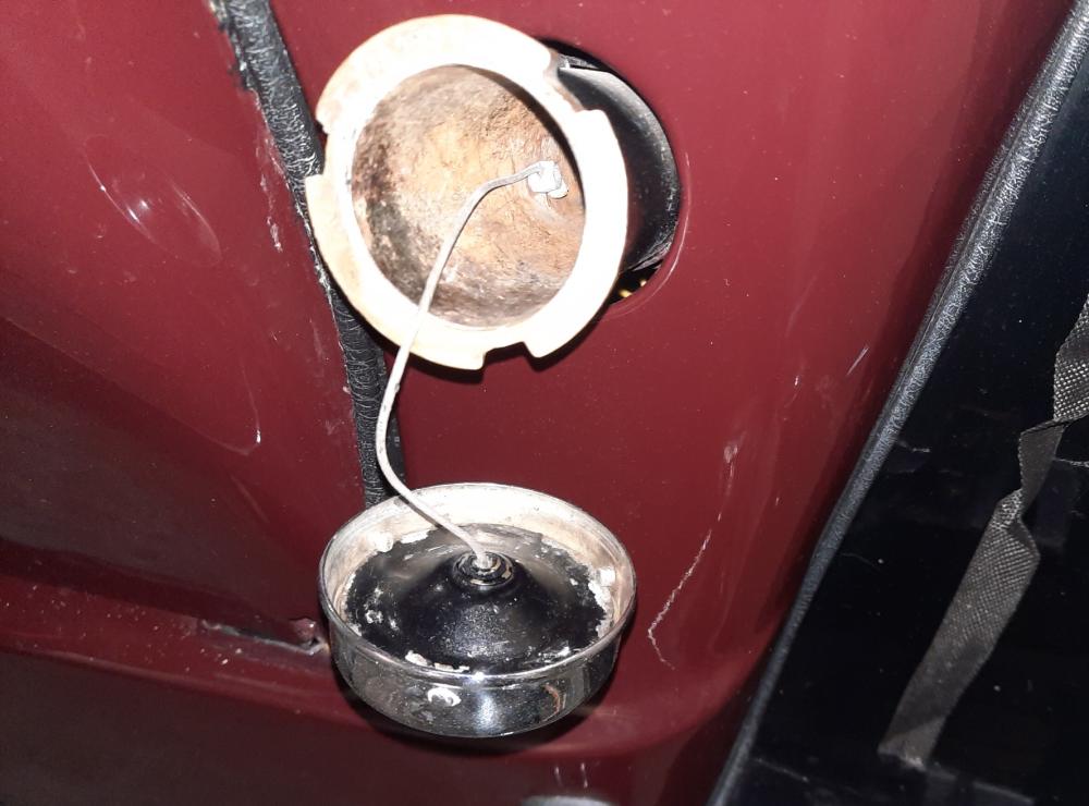

RE: Fuel Cap , Breather ?? - A G Wood - 28-11-2022
Agree with Ivor, the top one looks like an oil cap minus the critical clip which goes across the diameter and is retained by two rivets.
This is a Fourteen fuel cap, (minus the retention cable and cork washer) which I have been told is identical to the Seven version.
 Although Mike C mentions two pins...

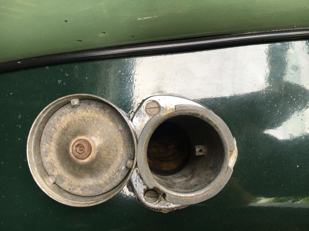

RE: Fuel Cap , Breather ?? - Graham Barker - 28-11-2022
Attached photo is of fuel filler on 1937 Ruby. I can't see how your cap relates to this.

RE: Fuel Cap , Breather ?? - Mike Costigan - 28-11-2022
I stand corrected - three pins it is!
Hi A G Wood, I meant that I can't see any relationship between my filler and the cap of k8207...  yours appears to be quite similar to mine.

RE: Fuel Cap , Breather ?? - Dave Mann - 30-11-2022
Your first photo is an oil filler cap which has lost it's retaining clip, here's a photo of a complete on C/O
